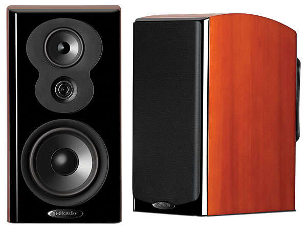

Those two lines of speakers were made from 2002, till a few years ago....when they released the Reserve and Legend series.
I am not sure where you are going with your comment, but over the last 20 some years Polk has had some truly good speakers.
They did not just start making good speakers in the last couple years.
Online speaker reviewing was not a big thing till recently and we were mostly at the whim of Stereophile and a handful of other big audio/video magazine online reviews, hence why Polks earlier lines are not as well known.
The LSi series are extremely impressive even all these years later. Whenever people ask me what speakers to buy, if they’re looking for used speakers that’s my first recommendation.
Some of my most enjoyable listening sessions ever were using stand mounted LSi7’s.
Still regret selling them.
