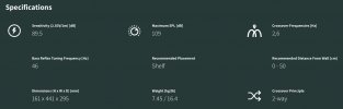

Forgot to reserve a post for Specifications. Here they are:
