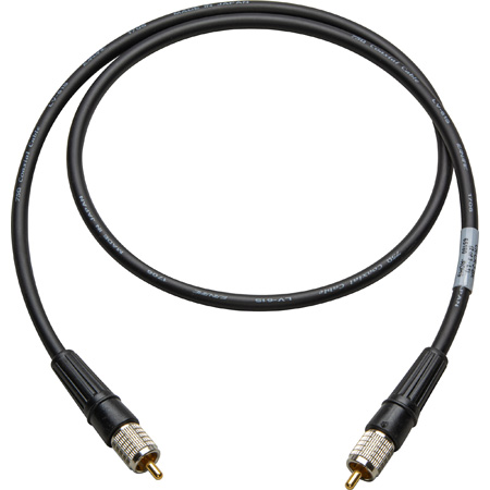

Just updated the system with cables that had been on order. These are beautifully made with Canare LV-61S & matching connectors & strain relief boots. Massive overkill, but just plain nice.

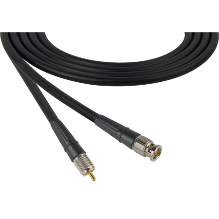

I ended up with the Node because of the physical controls with presets and the availability of eARC. For cables, you can use coaxial cables between each device (Node to sub, sub to speaker 1, speaker 1 to speaker 2). The sub uses BNC connectors, while the Node & speakers use RCA connectors. Standard RCA cables are fine with BNC to RCA adapters. I used the Laird cables in my post above with RCA to BNC connectors, Blue Jeans makes similar cables.
