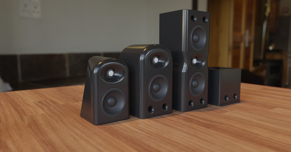

The waveguide on the tweeter makes all the difference. I thought a waveguide would be difficult to implement, but not any more. Low cost too. I should throw away all my flat baffle tweeters. They are all obsolete.
Before you do that, think about the 3d printed waveguides that are now available, which you can mount tweeters in. An example here:
Even 3d printed speakers:
Of course there are a lot of horns/waveguides for compression drivers, but that might be another matter?
Horns & Waveguides:
