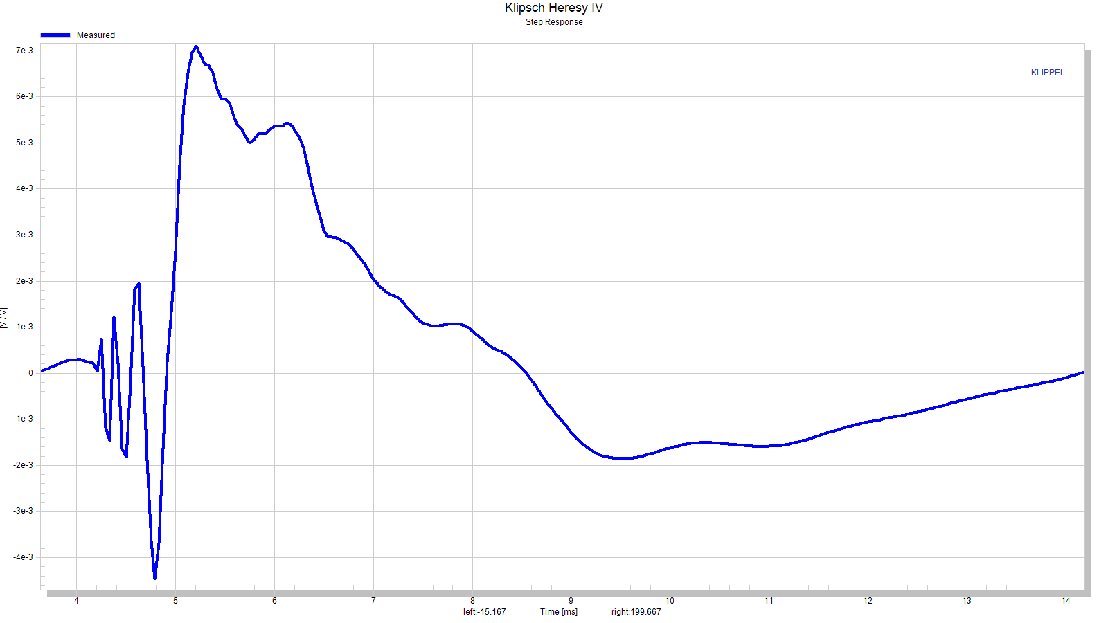

Extra Measurements:
Step-Response.
One of the reasons why I requested the phase and group delay plots (which I'm sure that you've got with your saved measurements) is to see the sources of this step response behavior. The phase and group delay plots (particularly excess group delay) will show you the places where you can use a DSP crossover to bypass the passive network, and take out the time delays of the midrange horn vs. the woofer and tweeter.
I'll still offering to contribute to your cause if you include these two plots in your measurements of loudspeakers.
Chris
Chris
See attached. I saw your previous request. Just hadn't gotten a chance to boot my laptop back up to pull the data over.
The only hesitation I had initially was simply due to the fact that my measurements are a two-step process for each angle; ground plane reference and 4-pi quasi-anechoic. Klippel's ISC module allows me to use the former as a "room correction" (of sorts) to then use the 4-pi to get anechoic. Therefore, I don't know how perfectly my data will align with *true* anechoic. But, I would presume them to be the same, or practically the same.
Hopefully this is adequate.
- Erin
