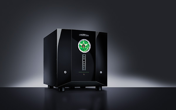

Has anything has changed? Or has is, in fact, gotten worse:
A big battery for your hifi, at only $50,000 for the basic version?
It seems we are still measuring poorly designed high priced speakers-
Hats off to armir for debunking power conditioners, op-amp rolling.
But why did he have to spend his valuable time doing this in the first place?
