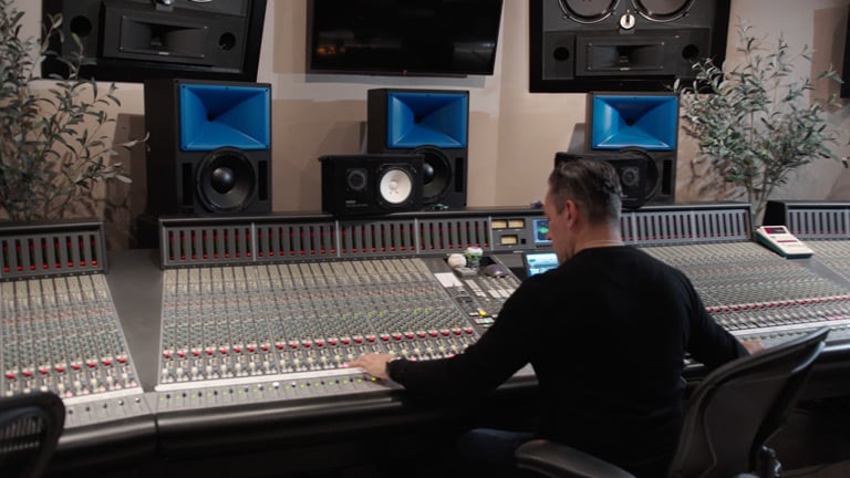

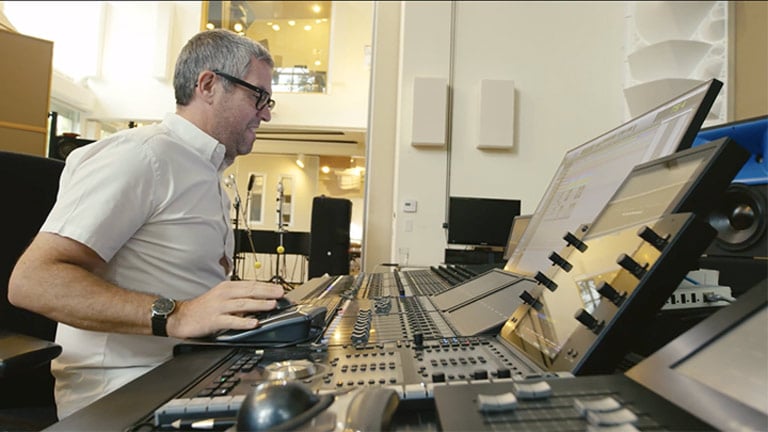

Have you tried Meyer Sound? The TAD R1TX puts you in the class of Meyer Sound Bluehorn.
And you can certainly get a sampling of it with the Ultra X20.
Think about how popular custom studio monitors using TAD drivers were in the past? Today, the highest end of the high end studios are using Meyer Sound:
The Bluehorn, Ultra X20, etc. are one generation newer than the Meyer Sound Amie.
