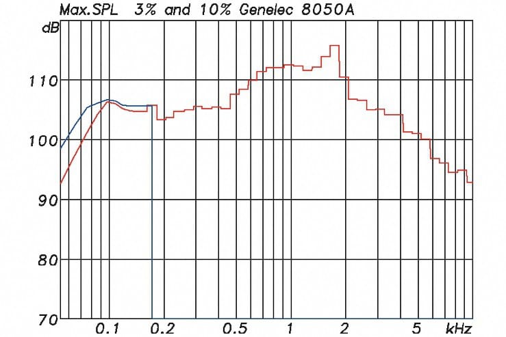

That review also shows the sharp drop in output capability below 100hz that presumably causes the issue in the 96dB test. It does not seem like any additional power was added between 8050A -> B, both are rated 150W(woofer).
