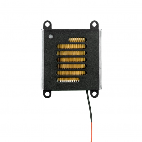

If the difference is so noticeable in a 4K video / AAC 192 kbps -> in that room it must be impressive. Those speakers use an expensive Mundorf AMT tweeter (acting as a dipole) that details the sound.
Air Motion Transformer Dipole
