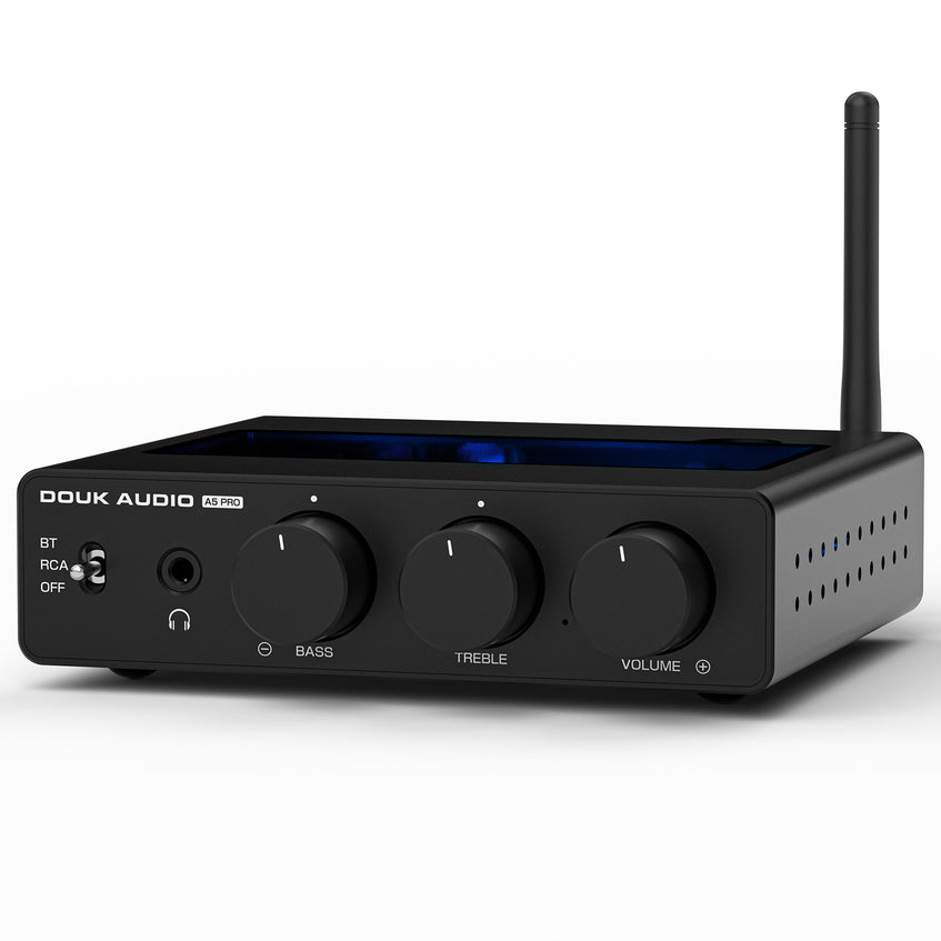

A5 Pro is now available...
The A5 PRO builds on the strengths of the A5, featuring upgraded Bluetooth 5.1 connectivity with a reset button, bass and treble knobs for precise tone adjustments, and a headphone output. It delivers clear, powerful audio, perfect for diverse uses from bedroom movies to desktop setups.
NB : what a pity, does not support LDAC !

It would have been nice if they kept the HP crossover knob with the pro.....
The model with bass management was more Pro than this one. Names got flipped!
Unless they further improved the actual performance of the A5 Pro over the standard one...which I don't see being the case.
