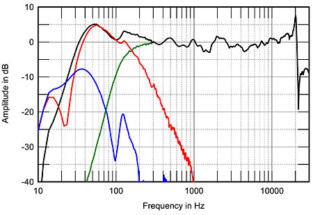

Stereophile measured their $30,000 speaker in 2006, here is the 30° horizontal listening window (anechoic above 300Hz):
Oddly, in 2010 they measured the smaller $16,000 version and it was better:
Unlabeled, I would have guessed this was JBL FR with the bass bump then pretty transparent. I bet those are not bad, especially for theater.
Looks like they were intentionally going for the smiley curve in the top model. The bass is insane, though. It puts the Salon2 to shame :oops:.
You can never have too much bass!
*Edit: nvm what I said about the bass, my brain thought the 30Hz line was the 20Hz for some reason. Still great bass, but not as epic as I originally thought.
