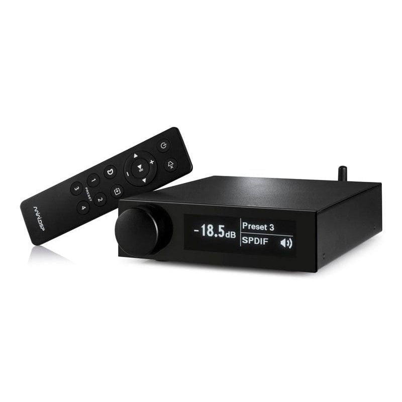

Adding Dirac Live to my existing system as the first step would involve
Buy MiniDSP Flex + UMIK-1 + license
Reading the manual (https://docs.minidsp.com/product-manuals/flex/index.html) seems I'd go with standard RCA version
First option would be PC via USB to MiniDSP Flex straight to sub & speakers via RCA as they're already powered speakers
Keep DX7 Pro as headphone DAC entirely separate
But then to swap between headphone/speakers, it'd be using my OS
Second option would be PC via USB to DX7 Pro, then digital connection to MiniDSP Flex, which then goes to speakers & sub
Headphones still to DX7 Pro
But then to swap between headphone/speakers, I'd be using the DX7 Pro
Does that seem right?

The DX7 Pro has no digital output which you could connect to the miniDSP Flex.
A DDRC-24 would give you Dirac for 250USD less.
Thank you. I had been overwhelmed by their product line but often saw Flex shared
Someone was kind enough to put a comparison table
In saying that, it's only $60 AUD difference from the only Australian store I can find
As well, someone else mentioned they found the presets for adjusting their sub.
I figured this would be an acceptable way to handle my loudness issue.
e.g. preset 1 for low volume, preset 2 for normal, preset 3 for loud
Much appreciated @staticV3, you've given me some great advice & corrections
Overall I'd like to do things once and do them right, so the extra features of the Flex over the DDRC-24 is worth the additional cost
In saying that, I'm sure I'd be happy with the DDRC-24
I almost started going down rabbit hole of SHD Studio and getting Neumann/Genelec at same time in balanced but decided against it
I'll spend a little bit more time researching other peoples configs with Flex, see what their criticisms, etc. are and sleep on it before ordering tomorrow

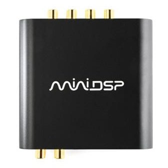

Thanks again. Ordered MiniDSP HT + UMIK-1 and license once it arrives
Couldn't see any reason to pick 8 over the HT (outside cost)
Won't upgrade to Neumann KH120 II just yet. Play around with room correction, enjoy it for a while, then go for it and appreciate the difference.
Minor update for those in future.
Had some extra cash so jumped on some KH120 II's on sale :P
Quite impressed by the MiniDSP software.
