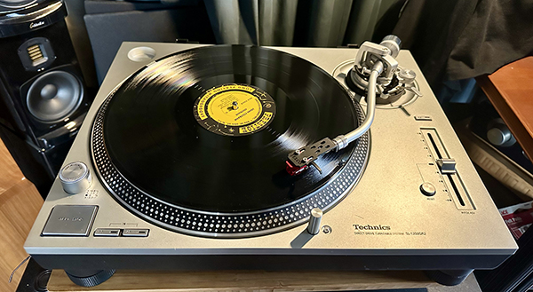

Hi everyone -
Long-time reader, first post.
I have a dedicated home theater that I also use for my 2-channel (as well as SACD). I am looking at doing something (to be determined) to upgrade my audio-listening experience. Most of my listening is 2-channel (75% vinyl, 25% digital). My vinyl/CD collection is in the neighborhood of 600. I have a collection of SACD numbering in the 40s. My room is decently treated for acoustics (walls, ceiling, carpet etc). My audio experience in my room is actually quite good. I have the room tuned well and things sound good across the board. I am not unhappy with anything in particular. I am more interested in taking it up a notch. I hadn't upgraded anything in almost a decade, but I recently got a new cartridge and phono stage and I have the bug again.
A friend of mine owns a local hifi shop and he is telling me that my natural upgrade path would be to get a Musical Fidelity M5si (through him), run it in HT bypass and plug my phono and digital sources into it for music. Now, I think I can use my main sub in both systems, but that would take a little digging to figure that out. But, if I were to go this route, I would lose my in-room Audyssey processing and HEOS. As these potential upgrades are just on paper, that trade-off doesn't seem like something I would want.
My thoughts are AMPS to replace my Marantz SR8001, a different DAC to enhance my digital audio listening, the aforementioned HT bypass, or other. I really like my TT and I don't want to upgrade that. Even though my SUB#1 doesn't play as low as some others today, I am happy with SUB#1. My acoustic treatments are pretty good and serve their purpose (perhaps I could look to adding some corner bass traps). My budget is in the ballpark of $2000 USD... for which I don't know what I want to do.
So... I'm reaching out to a community that I have been a reader of for a good while, but never posted before.
My gear is as follows:
  • JM Lab 816S, CC 800, SR800, PSB Alpha 3 for rears
  • Denon AVR-X3600h (disabled mains)
  • Marantz SR-8001 (power to LCR from Denon pre-out)
  • Paradigm PW2200 sub
  • Polk PSW10 sub#2
  • Technics SL1210M5K (Nagaoka MP-200)
  • iFi ZEN phono stage
  • Sony UBP-X800M2/CA Bluray
  • USB stick in Denon via HEOS for FLAC playback
Thoughts or questions welcome! TIA!
