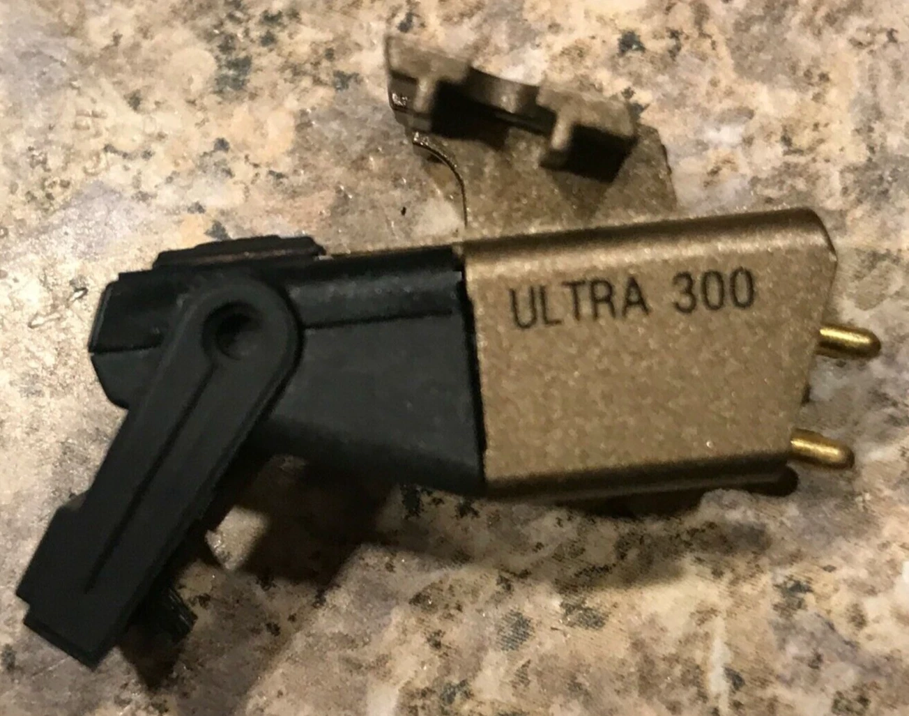

SHURE ULTRA 300 Cartridge.
I want to see this model with The P-Mount (T4P)
What you see in the pictures is the 1/2 inch version.
Since the 300 & 400 were ONLY available in P-Mount models, I am SHURE that you will have no problem finding that. The ULTRA 500 was not P-Mount.

    Since you are being both demanding and condescending, you may find the others on your own.
Great Shure TP4 collection, absolutely fantastic!!! But there was never a Shure 300 with T4P mount.
Then please explain to me why it needs an adapter to be mounted in a normal head shell?
Could it be that the truth that you do not seem to grasp is that it ONLY CAME AS A T4P?
Picture 4 of 9
Picture 4 of 9
This cartridge has a 1/2 inch mount, no adapter is needed for mounting.
This cartridge cannot be mounted to the T4P system
Ah'mmm OK, if you say so. .
