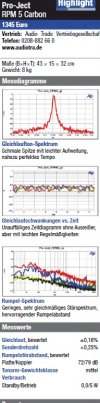

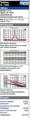

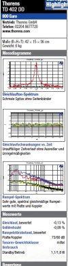

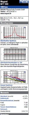

Hello… As I'm currently focused on purchasing a new turntable, I’d like to hear your thoughts and recommendations for my next one. My shortlist includes the following models:
  1. Technics SL-1500C
  2. Magnat MTT 990
  3. Pro-Ject The Classic
  4. Pro-Ject RPM 5 Carbon
  5. Thorens TD 402 DD
I’d prefer the SNR to be over 70 dB, but what is your opinion—would I actually notice a difference between a turntable with 70 dB and one with 80 dB SNR?
If there’s no real difference, then my next consideration is whether to go with direct drive or belt drive. After that, design and practicality matter.
What do you suggest?
You also have the technical measurements in att.
Thank you.

Direct drive would be my recommendation, just less kerfuffle.
As to 70 or 80dB S/N ratio, you won't get anything like that off a record. Even just the phono stage has a S/N ratio of somewhere around 70dB at best, with a very few notable exceptions. S/N numbers for LP playback are also heavily affected by the RIAA equalisation and our hearing's weighting, so can't be easily or directly compared with S/N ratios for electronics.
Direct drive gives the least trouble, lowest maintenance and easiest set-up. Generally, but not totally, DD also gives the best technical performance in terms of speed accuracy and lower W&F.
Unless you're interested in vintage turntables, in which case there are also the idler drives to consider, a modern DD would be my choice every time.
S.

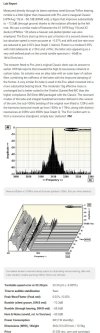

Direct Drive would also be my choice. Perhaps add the Denon dp3000ne to the list. The recent HiFi news testing revealed exceptional numbers. While the Technics motors edge everyone else, the Denon tonearm has better features.

If you look at Thorens 124 DD measurements in HifiNews, you will quickly strike any Thorens DD off the list, 402DD does not impress either. What remains is the Technics, Just make sure you get one with a perfect even and non-wobbly platter.
