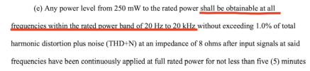

How does one become compliant with "shall be obtainable at all frequencies" if not by actually obtaining, while testing? ;)
But it doesn't say anything about which bandwidth should be used during the test/measurement. It should, especially for class D amplifiers, have a rather decisive effect on the result, right? Regarding distortion in the higher frequencies that is.

Regulations don't work like that. You can't have a regulation that is open for interpretation by each manufacturer and, separately, by the government. Tell me, what did FTC mean, and how do you know from the rule, as written?
1. All frequencies between 20-20KHz must be tested, each for 5 minutes to not exceed 1% THD+N
(how does one even do that? - this is literally the wording of the rule)
2. The test must be run at 20Hz and 20KHz
3. The test should be at 20Hz, 1kHz, 20KHz
4. The test should be at 20Hz, 100Hz, 1KHz, 3.5KHz, 10KHz, 15KHz, 20KHz
5. The test should be at 32 points, linearly spaced between 20 and 20KHz
6. The test should be at 64 points logarithmically spaced between 20 and 20KHz
And then, what bandwidth of measurement should be used for the 1% THD+N calculation? 20KHz? 48KHz? 1MHz? 1GHz? Where are the details needed to reproduce a reported non-compliance test should FTC come after my published specifications? As a non-layman, you already know that the exact conditions of the test need to be specified if one wants to reproduce and compare the results.
The rule is poorly written and opens up manufacturers to the risk of legal action, regardless of how they interpret it.

My 'interpretation'? I don't see anything needing much 'interpretation'. The Commission has clearly stated they regard a single 1kHz power output rating as deceptive and amplifiers are required to output their full rated power across the accepted audible bandwidth if they are to claim ANY power output rating above 2W. Whether some little website owner agrees or disagrees is irrelevant.
Specifically, 250mW to rated maximum power shall be obtainable for a period not less than 5 minutes, at any frequency within the specified bandwidth (default 20Hz-20kHz) with distortion (+N) not exceeding either 1% or the manufacturer's rated distortion and noise figure below that. A manufacturer can specify well below 1% for their FTC compliant rating if they so wish, but not above it.
