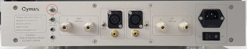

I was hunting around for a Purifi 1ET9040BA implementation that I really like. I found this power amplifier from Cymax and wanted to share some photos of its design, which has been very thoughtful and high in its quality of implementation and design.
It has dual XLR inputs which enables me to connect my Network Streamer and LR channel of my AV Processor to the Cymax power amp, and have the inputs and gain easily selectable from the front with its rotary dial with LCD display. I love the shielded power supplies and that it uses a linear power supply for the input op-amp boards, keeping the Hypex SMPS1200A180 to power the Purifi 1ET9040BA amp module in dual mono configuration.
Their website allows configuring for various options so I have spec several upgrades
Black shielding for Hypex SMPS1200A180 (Dual Mono)
Blue shielding for Linear Power Supply for input buffer and power management
Rotary dial features a LCD display with user selectable XLR input 1 and 2, and user selectable Gain 1 (21.4dB) and Gain 2 (28.4dB)
View attachment 402314View attachment 402317View attachment 404815
Equipped with Furutech FI-06 Rhodium NCF IEC socket.
Input 1 - Furutech XLR Rhodium socket
Input 2 - Neutrik XLR Gold socket
Output - WBT 0703 Silver
Weiss OP2-BP input buffer board fed by linear power supply. Neotech UP-OCC copper wiring, nicely implemented.

At first blush, I couldn't differentiate between the MK2 Dual-Mono, Pro Dual-Mono, and Pro MK2 Dual-Mono versions.
All three are available with my desired configuration:
WBT 0703CUAG Speaker Binding Posts
Neutrik Gold Plated XLR + RCA
Furutech Gold Plated Power IEC Inlet
Neotech UP-OCC Internal Input Signal & Speaker Wires
Red Copper Nickel Plated Power Supply Shielding/Cooling Heat Sinks + Partition
Price as configured above with SS2590:
$2,615 MK2 Dual-Mono
$2,766 Pro Dual-Mono
$3,221 Pro MK2 Dual-Mono
