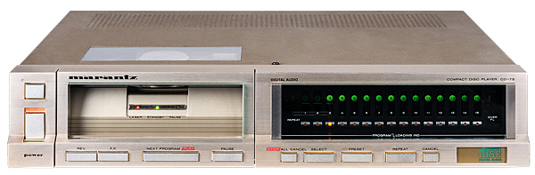

I would love to see measurments of the first commercial CD player. The Sony CDP-101.
Not quite the CDP-101 but still interesting!
