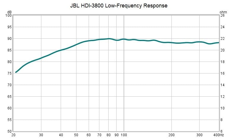

...It is a nice engineering feat to produce small bookshelv speakers that extends to 30 hz it looks nice on paper but is meaningless as they never provide enough output in the bass anyway
THAT is a very true point. Fielder and Benjamin wrote a paper about essentially that point-if you can't generate enough SPL at a given bass frequency, you literally cannot hear it due to Fletcher-Munson and it is useless. Still valid to tune low to avoid bottoming, though 40 Hz is low enough I'd say.
Larson did a ground plane measurement of bass HD-38000
My guess is that HD-3600 is almost same, just with higher distortion. Amir's NFS measurement looks different
