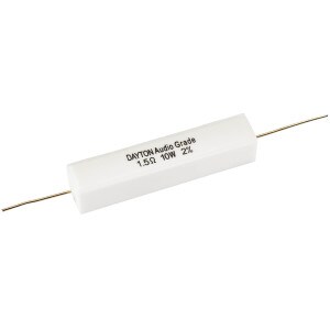

Main product image for Dayton Audio DNR-1.5 1.5 Ohm 10W Precision Audio Grade Resistor
Part #004-1.5
Per item price :
$1.49 x2
$2.98

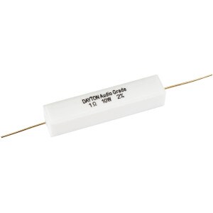

Main product image for Dayton Audio DNR-1.0 1 Ohm 10W Precision Audio Grade Resistor
Part #004-1
Per item price :
$1.49 x2
$2.98

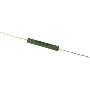

Main product image for Dayton Audio DPR10-20.0 20 Ohm 10 Watt Precision 1% Audio Grade Resistor
Part #006-20
Per item price :
$1.79 x2
$3.58

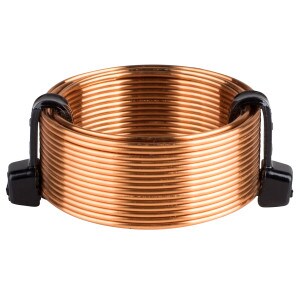

Main product image for Dayton Audio 0.10mH 20 AWG Air Core Inductor Crossover Coil
Part #257-020
Per item price :
$3.39 x2
$6.78

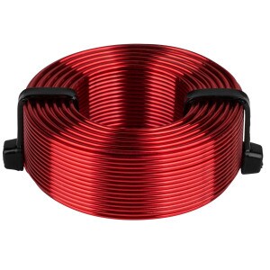

Main product image for Dayton Audio 0.27mH 18 AWG Perfect Layer Inductor Crossover Coil
Part #257-810
Per item price :
$5.79 x2
$11.58

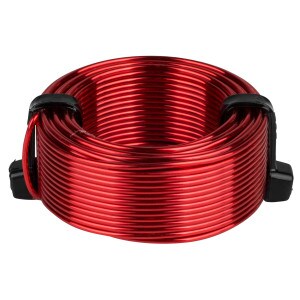

Main product image for Dayton Audio 1.0mH 18 AWG Perfect Layer Inductor Crossover Coil
Part #257-826
Per item price :
$9.98 x2
$19.96
