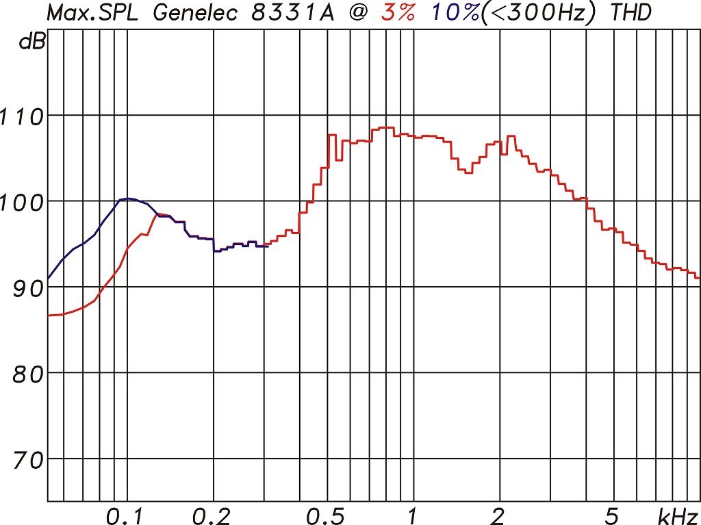

There is an S&R review. The biggest problem with the 8351A is it has a first gen Ones woofer design that had very poor output at some frequencies, particularly the dip at 40-70hz where it performs comparably to the later generation and much smaller 8331a.
The 8351B also has a larger midrange and tweeter as well as more refined performance overall. If you are getting 8351a at a very big discount and planning to use subs it may still be worthwhile. The overall sound isn't going to be that much different.
