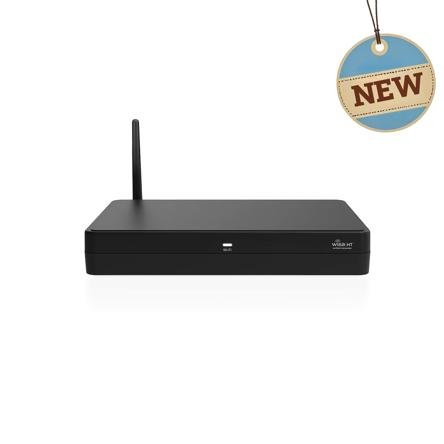

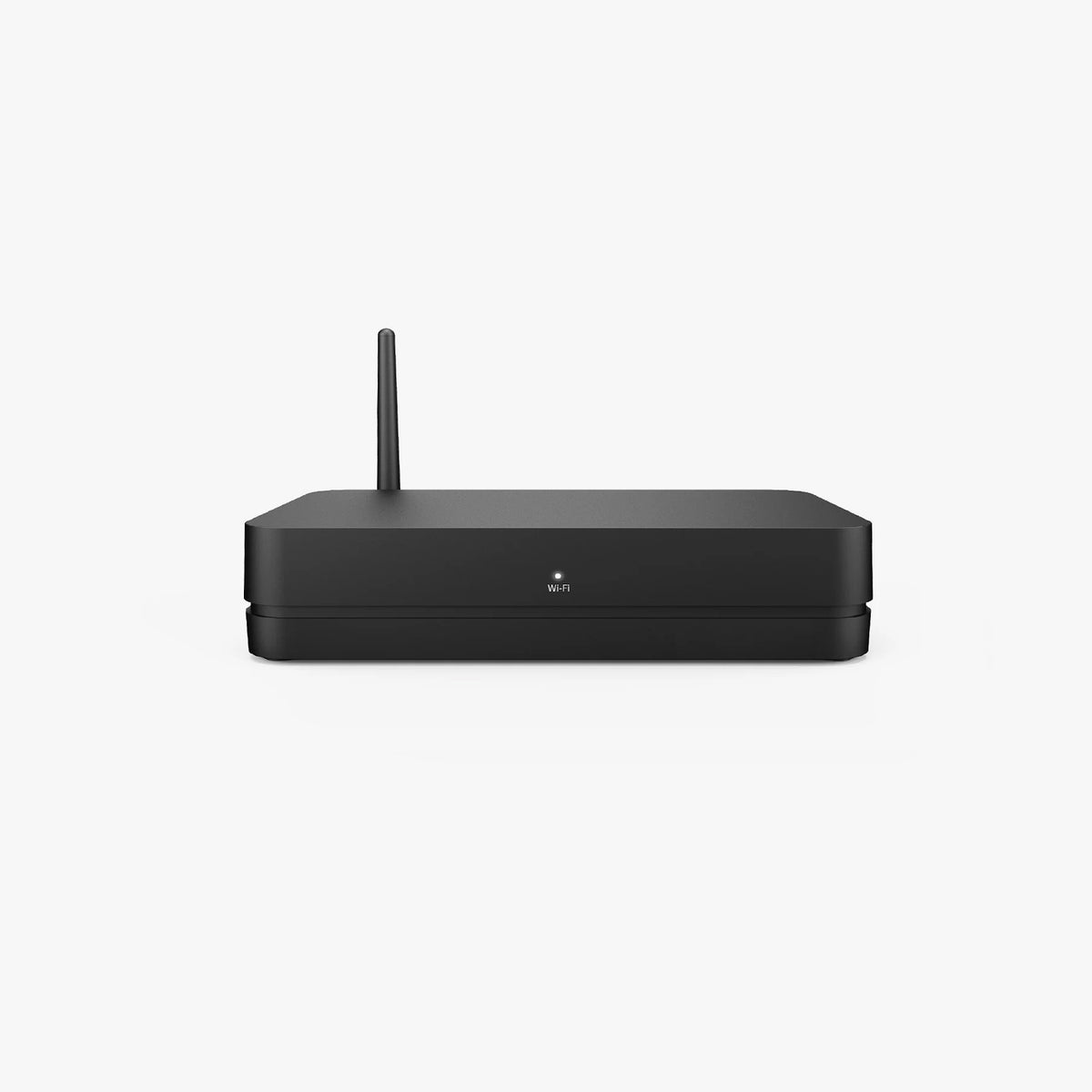

One thing that seems strange: am I missing something, or do these only have analogue audio input? No digital input option?
Digital option would be over WISA.
An absolute no brainer if you've got the bucks. That little bit of bass distortion at 96 db will be inaudible with a couple of subs crossed over at around 100 hz. It does look a trifle, shall we say, utilitarian, but just play in the dark as you would with any other great performer.
Terrific review, Amir.
Here's what Mesanovic suggest you use to expand digital inputs:
