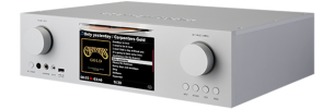

Has this been verified? Cocktail Audio (from Korea's Novatron) has streamers like this (both with and w/o DACs), but they are loads more expensive. However, their HDMI audio out only supports stereo streams as far as I am aware. Below are pics/thumbnails of their premier model's front & backside. Eversolo's DMP-A6 Streamer's price is a bargain compared to these Cocktails.
