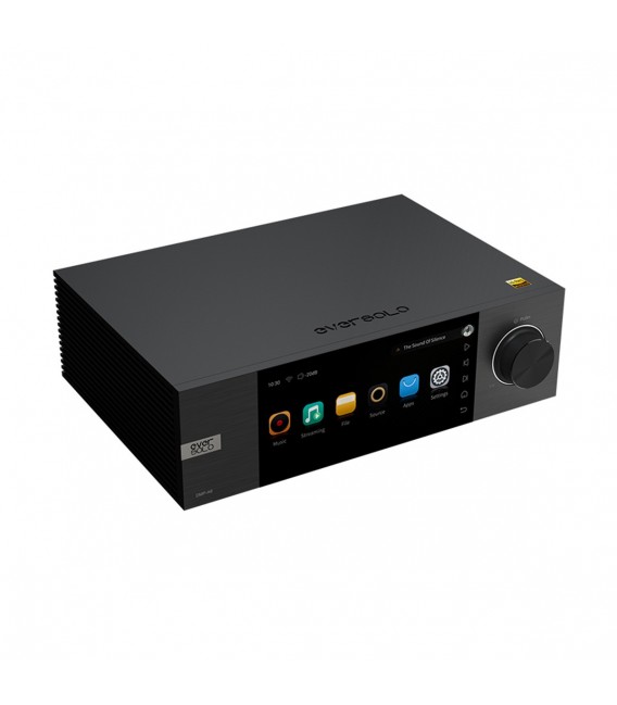

This is a review and detailed measurements of the Eversolo DMP-A6 Streamer and balanced DAC. It was sent to me by the company. I don't have the price but see it on sale for US $850.
The DMP-A6 design is absolutely gorgeous. A large, high contrast LCD allows it to show realistic visualizations like the above VU meter. Navigation is easy to use with extensive configuration options. The OS seems to be Android but custom audio pipeline is provided to provide bit-exact playback.
Support for usual streaming services is provided (pulll method) in addition to support for Roon (pull method).
There is an internal SSD which can be up to 2 Terabytes, allowing large music libraries to be stored locally.
Volume control is very responsive and displays a large circle in the middle while changing volume. I wish that could be configured to stay on screen as otherwise it is hard to see the current volume control (and in visualizations like above it is not displayed at all).
They claim it (edit: Audiophonics did, they just corrected the spec for "LCD") to be OLED . I know this would be somewhat polarising choice for many, but I don't consider it to be an issue in realistic use cases.

They claim it to be OLED. I know this is somewhat polarising choice for many, but I don't consider this to be an issue in realistic use cases.

They advertise it as LCD but who knows.
OK, I guess the manufacturer itself knows better ! ;)
Specs by @Audiophonics :
Edit: corrected since.
