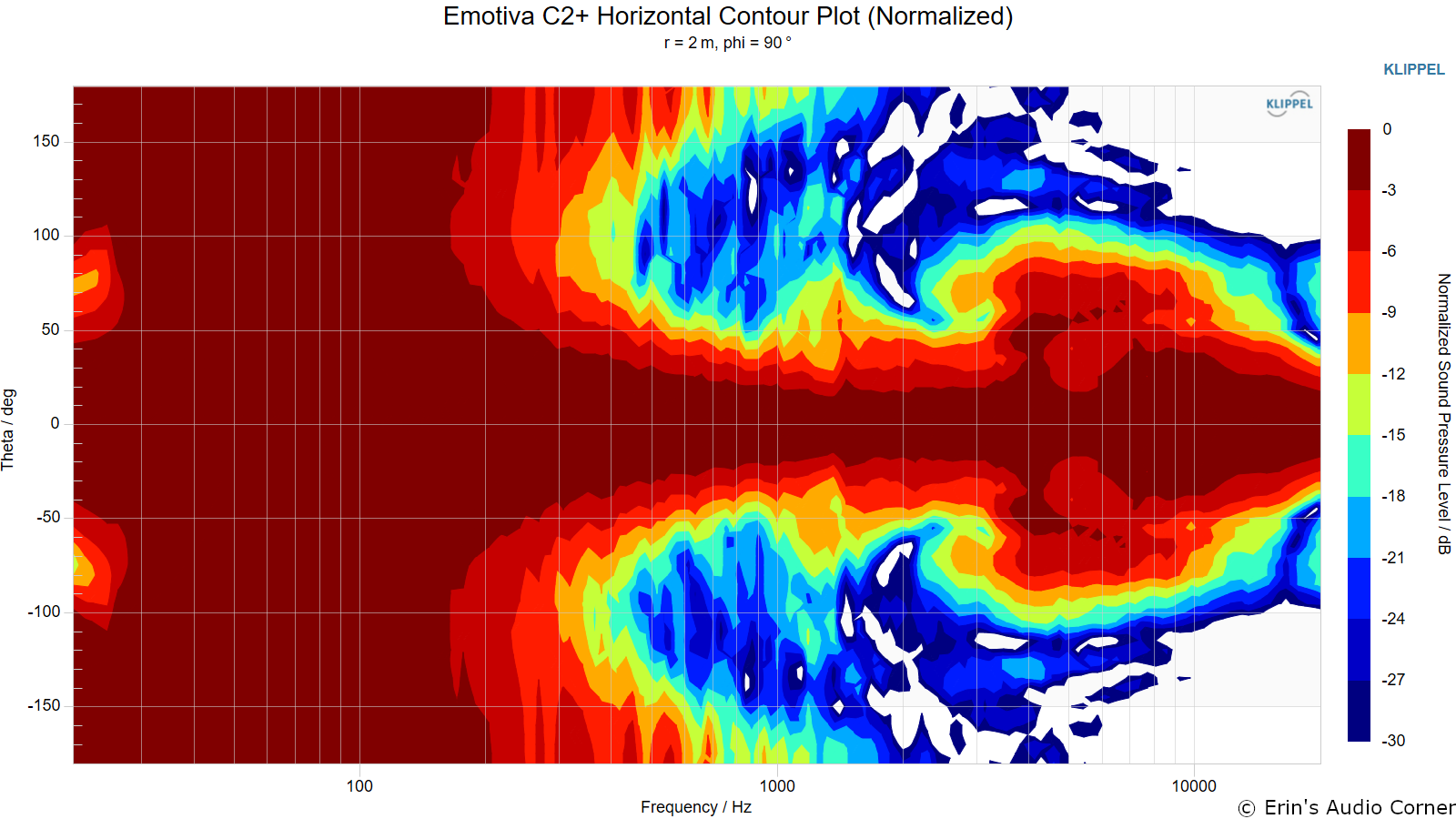

I think what you’re paying for here is output in lieu of linearity. This speaker is big and imposing. It has plenty of volume (no pun intended) to make most home theater enthusiasts content. Though, the response linearity could use work but that’s commonplace with center channel speakers, unfortunately. The price is a great intro as well. Just mind where you sit; don’t sit too far to the side or too high above the tweeter.

I can’t help but think that the C2+'s little brother, the C1+ would perform better in this regard (related to peak/dip in 1.5khz) simply because it has only a single midrange.

This has comparable directivity to the Revel C10 and obviously way more output and bass, which I think still makes it one of the better centers we've seen reviewed. But yeah, lets see that C1+ :P
Eh, that horizontal directivity due to the double 3" mids is pretty nasty looking. I would not purchase this over the C1+. They should definitely address the lobing issue in the next revision. Maybe one 5.25" mid along with a larger AMT for additional power handling and max SPL headroom.

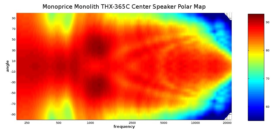

Yeah the horizontal dispersion and frequency response is horrible. Wow. The Monolith 3 way has similar output but neutral with good horizontal dispersion. Hell I'd bet the Klipsch rc64 outperforms this.
A bit disapointed by this, rly wonder how the monolith thx 365c compares to this, since its the main competitior in the price class
It was tested over at audioholics and did really well. I can not get over how little the Monolith THX speakers are talked about with their price to performance. It's baffling.
Look at the horizontal dispersion of the center.

what's the point of having two mid-ranges? they literally shot themselves in the foot.

Emotiva chose to tradeoff dispersion for output which might make sense for some customers with a long listening distance.
That's not how you do this though, we don't add a second tweeter for higher output.
they should sacrifice linearity for sensitivity / Xmax increase, because linearity is already sacrificed this way anyway.
I think they just wanted to recycle the mid-range from C1+
Because baffle step doesn't effect the tweeter. But it does for midrange. You gotta make back that 6dB loss somehow and that's why you see multiple woofers/mids in many designs.
