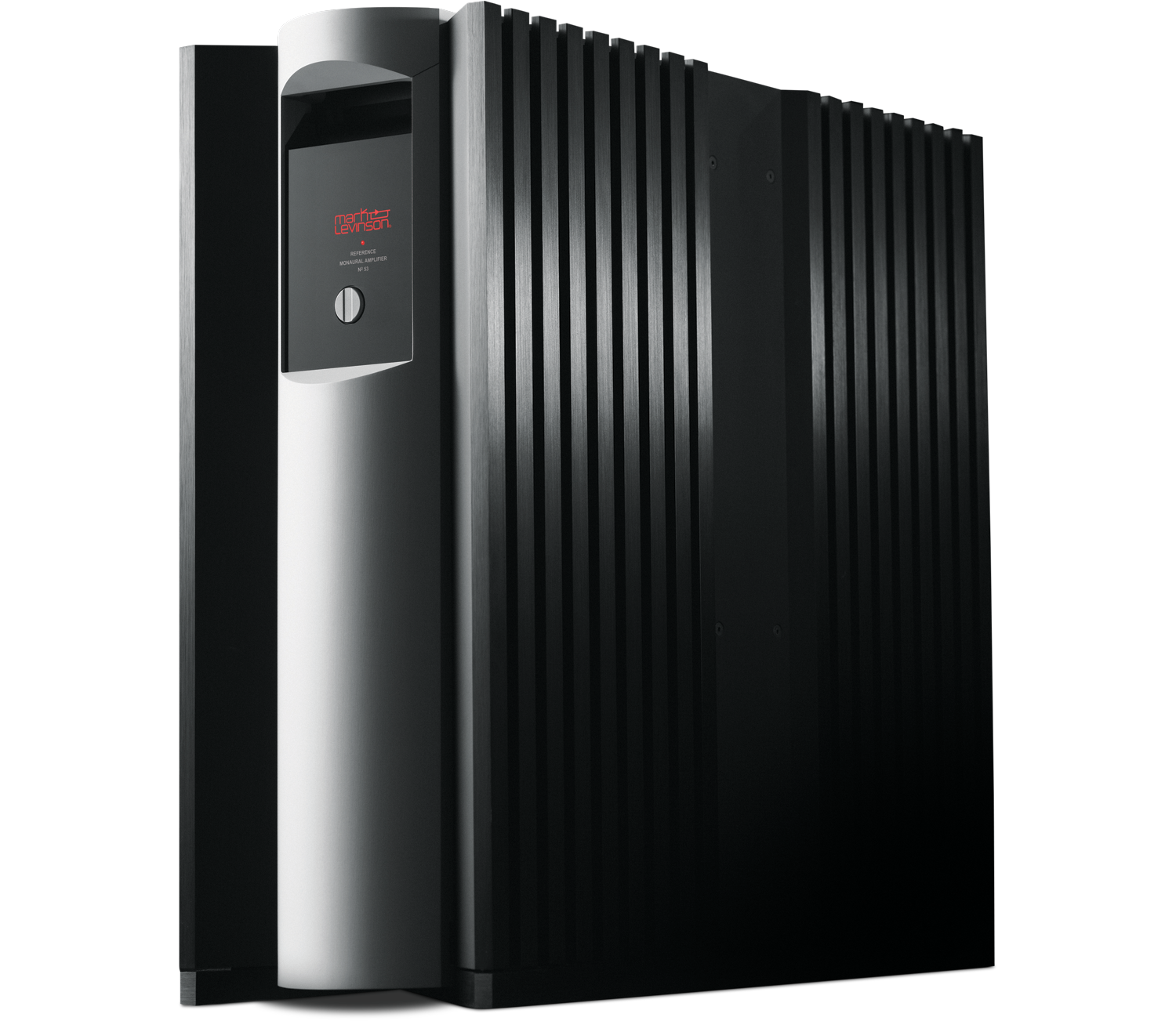

Mark Levinson No 53:
Now we are talking sweet!!
