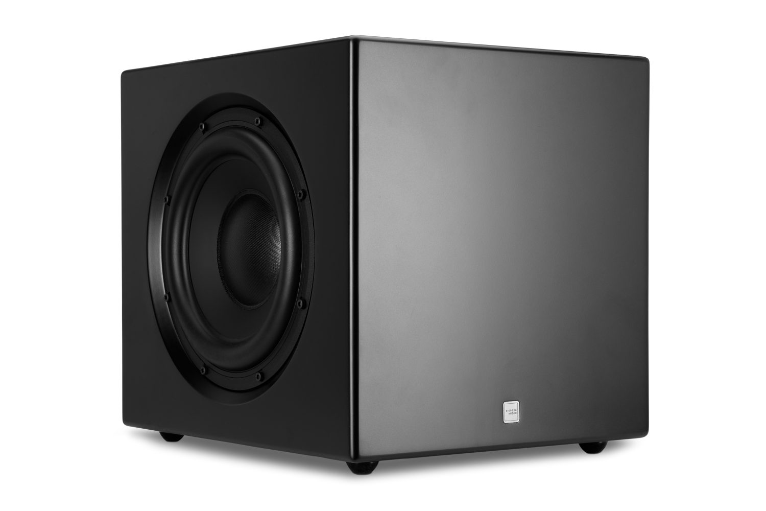

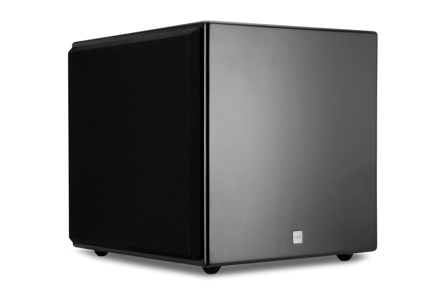

I guess this means our specs are mostly finalized too:
  • Frequency response:
    25-250hz +/-3dB (ground plane)
    22-270hz +/-6dB (ground plane)
    19-250hz (typical in-room response)
  • Max SPL @ avg 30-80hz/1m RMS:
    ~117dB
  • Dimensions (WHD):
    360x370x410mm (425mm with feet)
  • Weight:
    27kg
