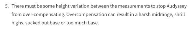

I got a question on the room correction of MultEQ app For my old Denon x1300w and x4800. Need some advice from the pros.
It seems like for Audyssey 0-200hz, it flatten the trace for x4800h. But both my x1300w & x4800h have same filtered freq till 201hz.
ive turned off midrange compensation.
Is that normal or I need to change some setting In the avr?
X1300w multieq app filtered freq till 201hz, Front spk and Center spk
x4800h MultEQ app filtered freq till 201hz

I came across this statement. The height for all the 8points need to be varied?
I try to have exact same height for the 8positions.
I saw the secrets to Audyssey Guide.
