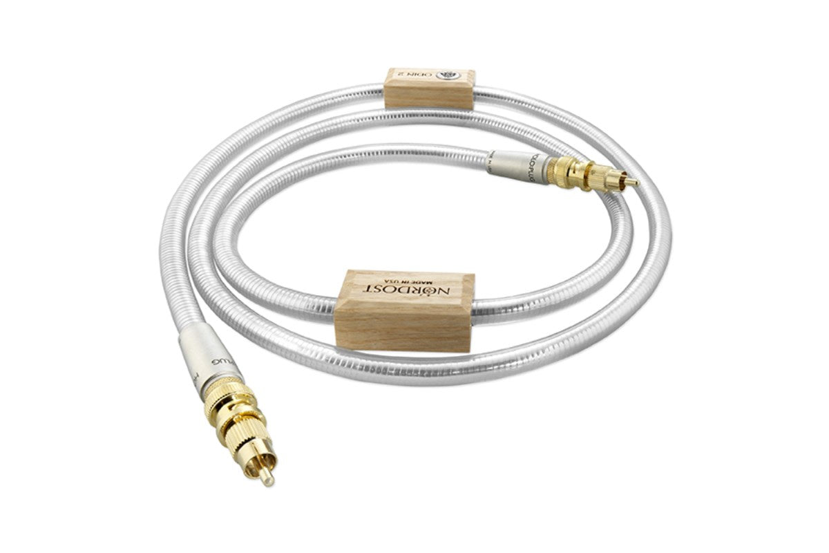

For these devices, must use an external linear adapter that costs at least $3,000 or more for a BNC cable (x2) and a similar price. :facepalm:
I hope you are sitting down as the cost of the Nordost TYR 2 coax cables I used for testing is US $1,750 each! So that requirement was more than met.
So kind of on the low end for Nordost right? ;)
Would have gotten good results with Nordost Odin 2 Reference. 1.25 meter for $12,999. Remember you will need two of them.
So the cable would cost near 5 times the device tested here. Always put the most money on the most important part. People always try and low ball it and well you see what happens.
