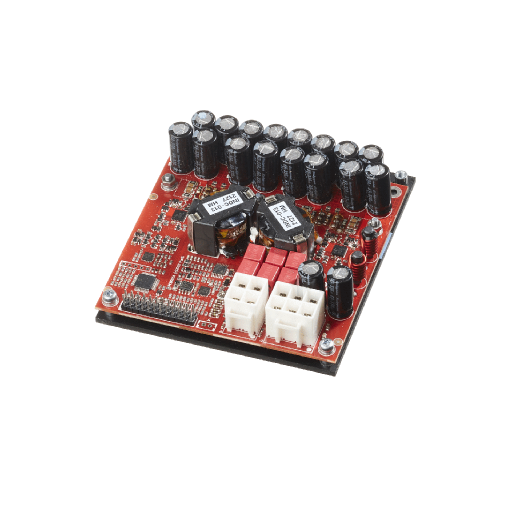

As I understand, The faulty pilot batch had a misplaced protection diode that was causing trouble for one of the op amps. unfortunately not caught soon enough since it only showed up close to clipping and at high frequencies. A very frustrating mistake indeed.

regarding serial numbers and the recall of faulty units:
As we stated earlier: it was a pilot run from June that subsequently was recalled which means we notified the recipients (OEM early adopters). One of these modules somehow managed to escape the recall and ended up being reviewed. It is very unlikely that there are any more modules escaping the recall and even less likely that they ended in the hands of end users. We are of course double checking our logs to verify and will act accordingly but it takes a bit more time due to the holidays.
If anyone owning a 9040 still wants reassurance they are very welcome to query us with their specific serial numbers and we will check after the holidays.
Again, a recall means that we contact the owners directly and this recall was some time ago. Volume production has been running since then and the end of line test tightened.
The only reason we did a public statement was due to the review of a likely faulty module which could cast doubt about the modules general performance or the end product integration. Again, a recall means that we contact our customers directly.
