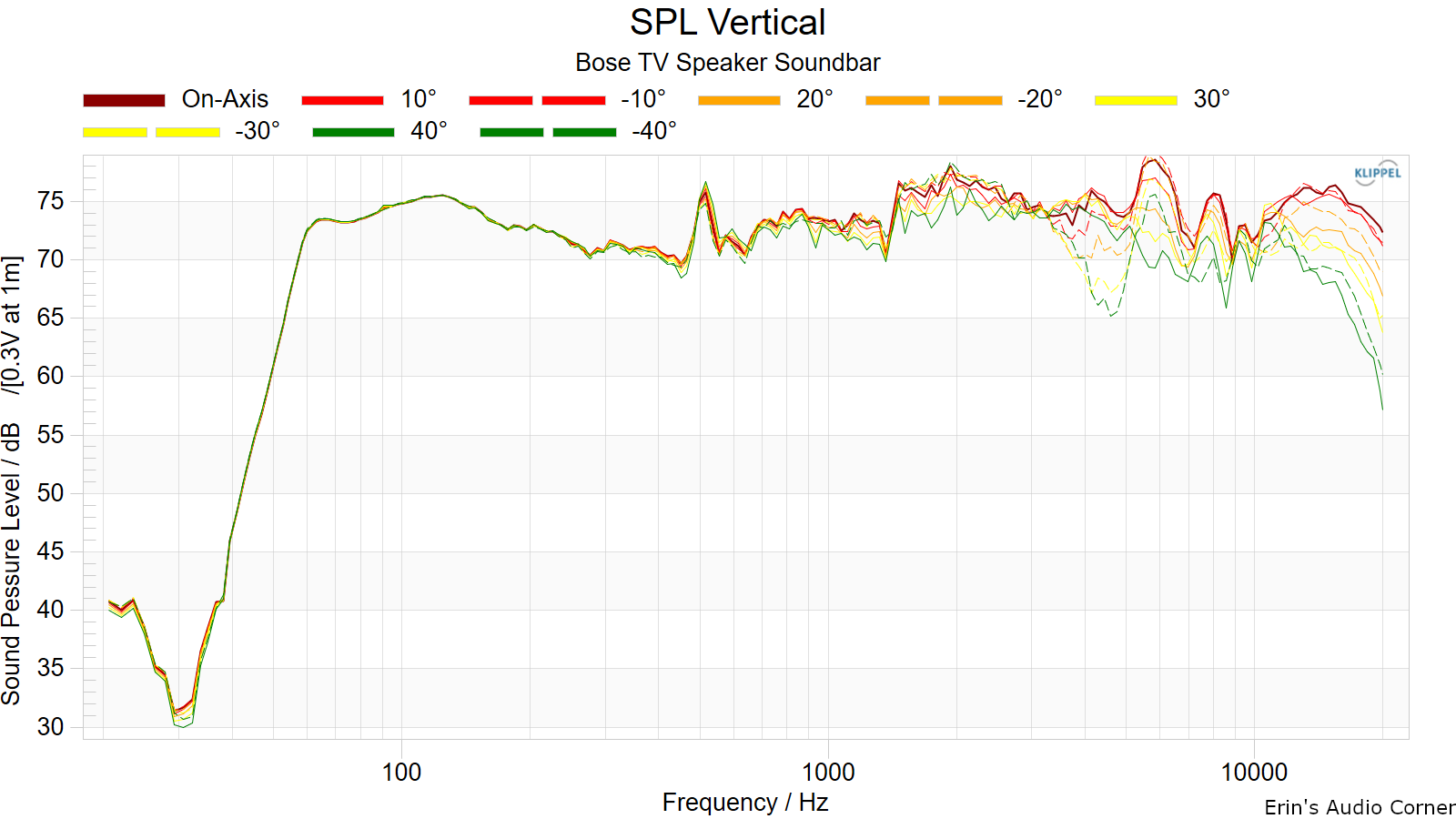

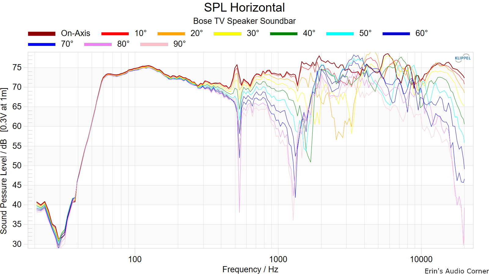

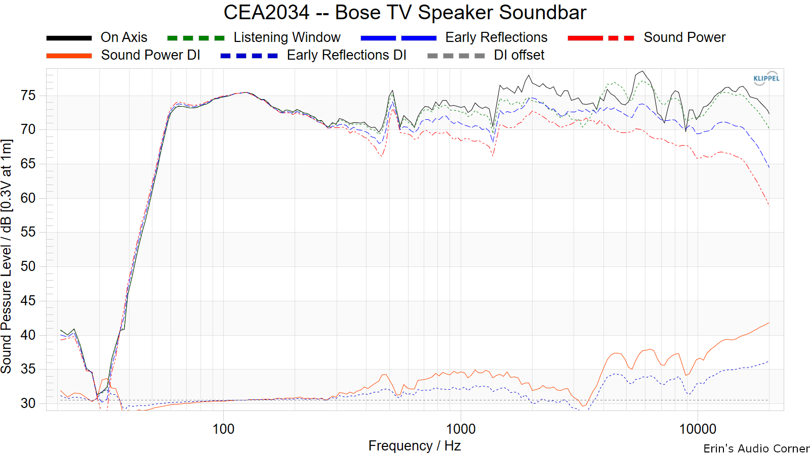

CTA-2034 / SPINORAMA:
Early Reflections Breakout:
Estimated In-Room Response:

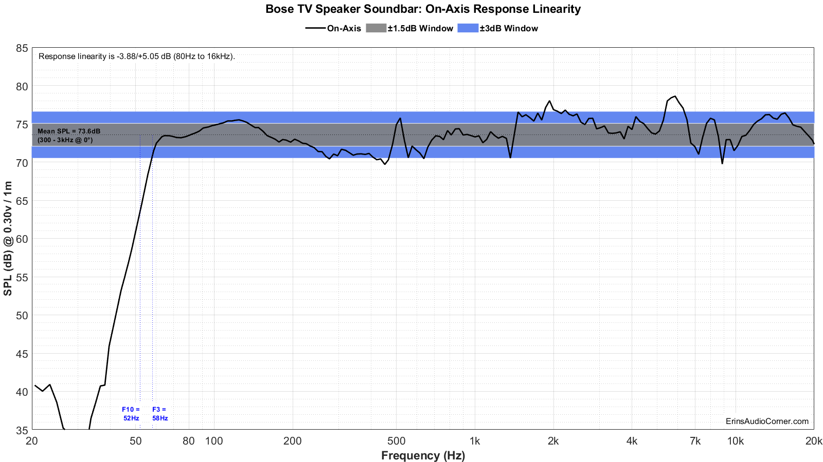

On-Axis Response Linearity

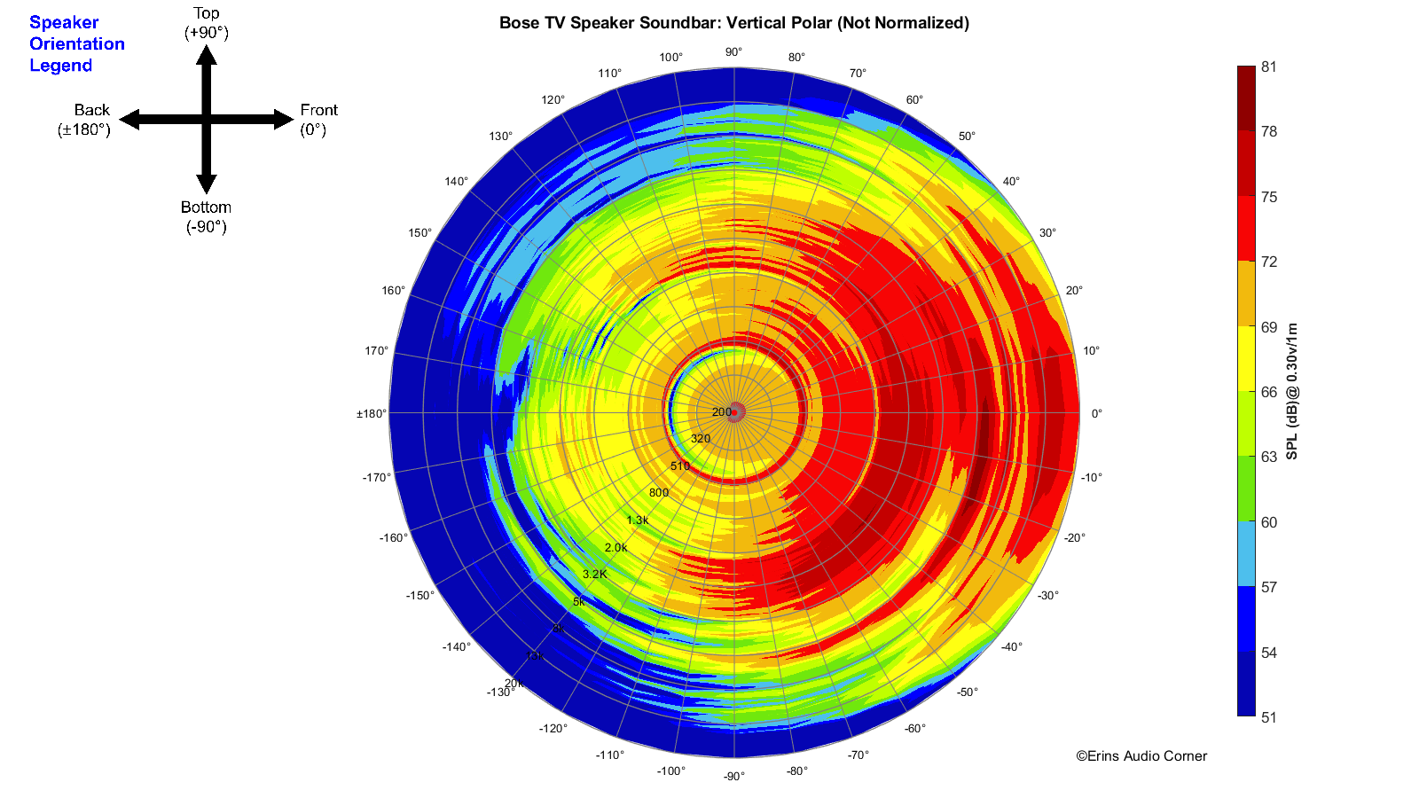

Vertical Polar (Globe) Plot:

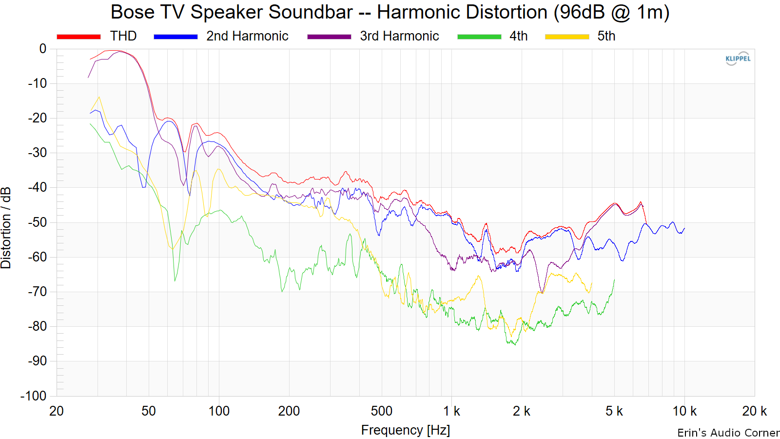

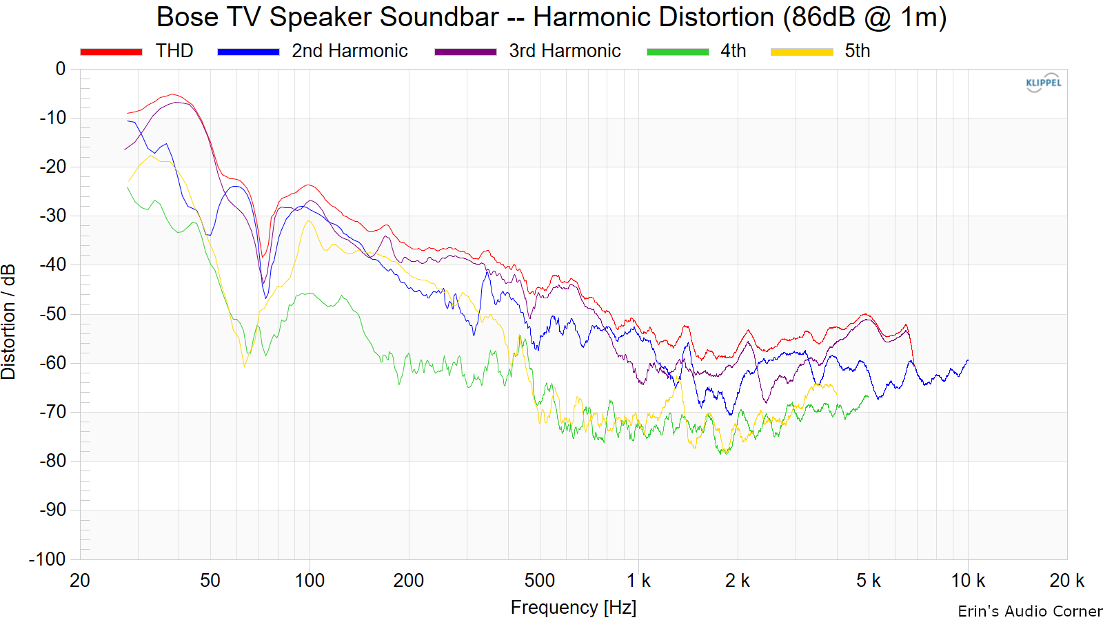

Harmonic Distortion
Bose%20TV%20Speaker%20Soundbar%20--%20Harmonic%20Distortion%20%2886dB%20%40%201m%29.png
Bose%20TV%20Speaker%20Soundbar%20--%20Harmonic%20Distortion%20%2896dB%20%40%201m%29.png
  2. 86dB at 1 meter (red)
  3. 96dB at 1 meter (blue)
  4. 102dB at 1 meter (purple)

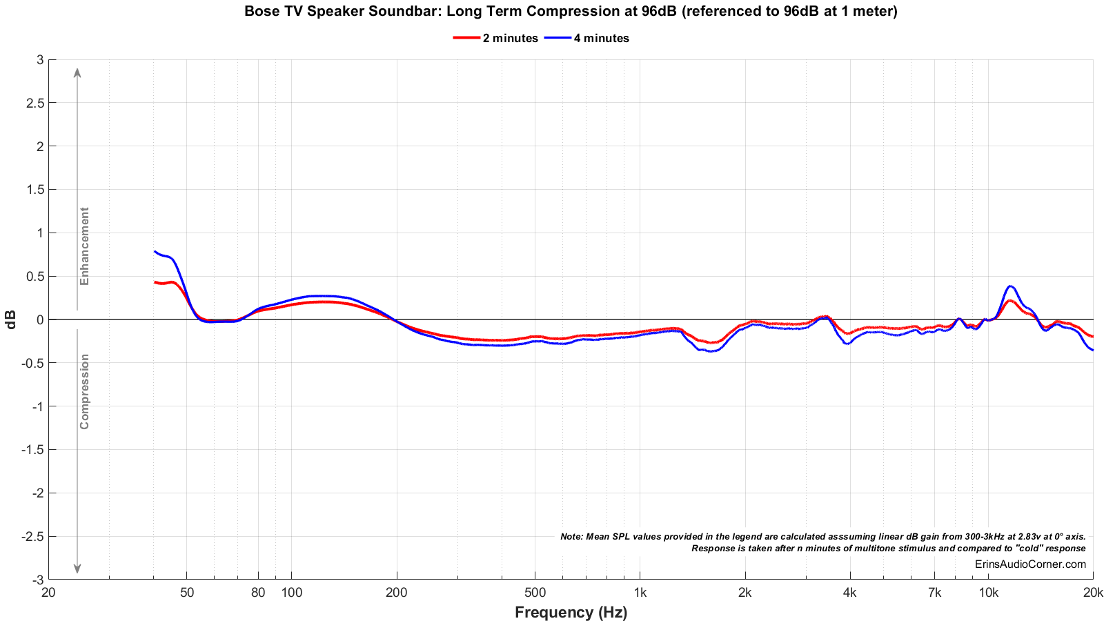

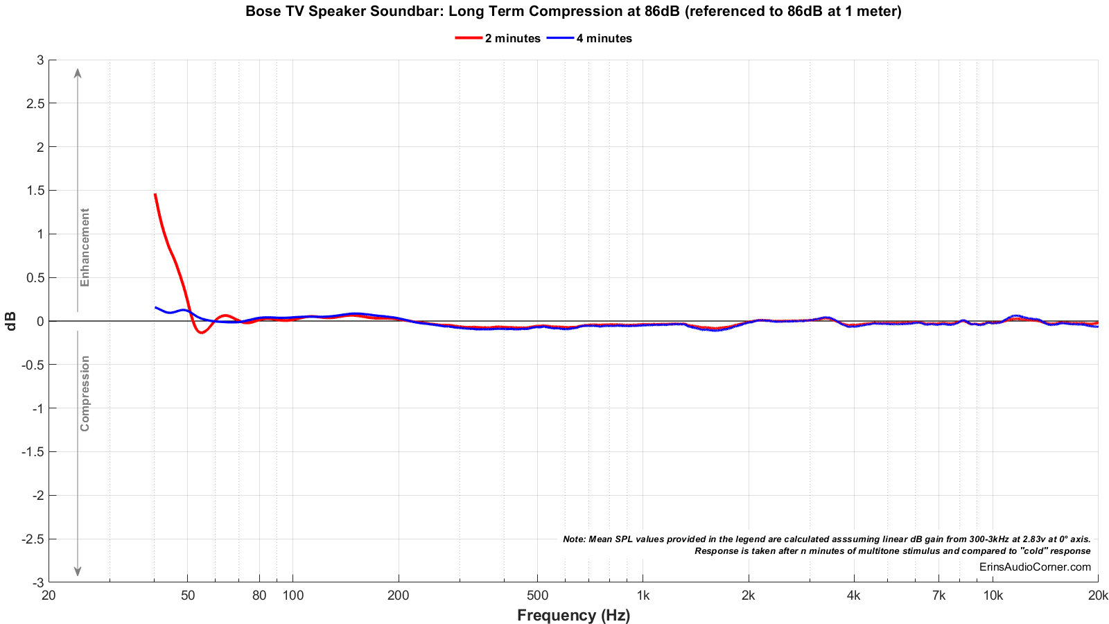

Long Term Compression Tests

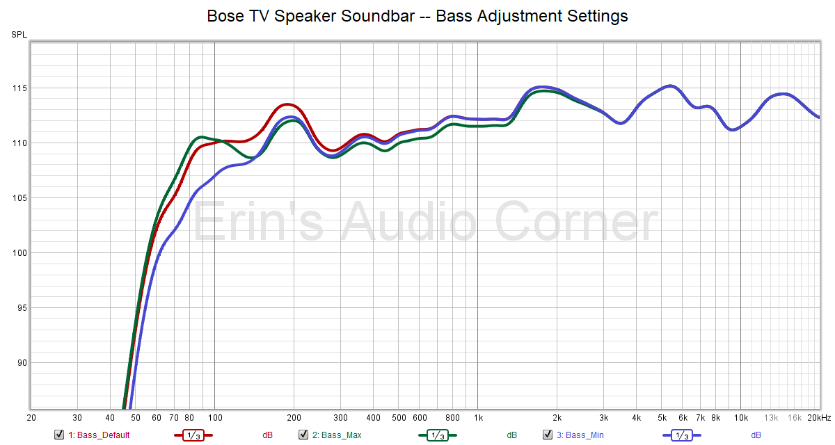

Bass Adjustment
This soundbar features a bass level adjustment. I have provided the relative changes below, referenced to the default (normal) bass adjustment.
Note: Measurements are not anechoic; data is intended to be analyzed for differences in settings.

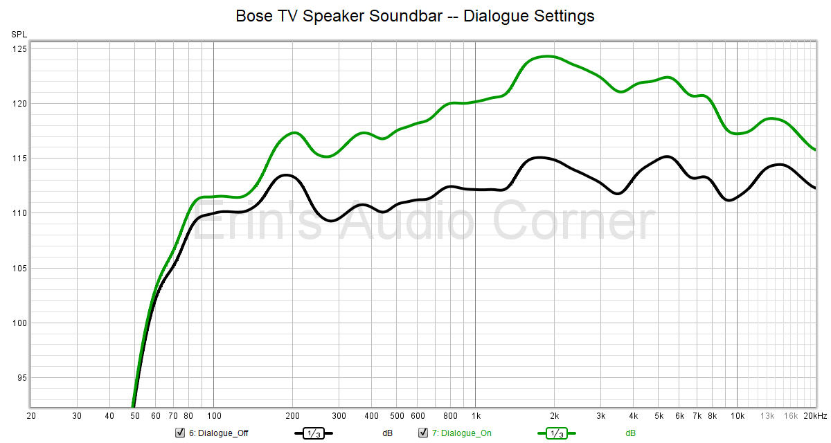

Dialogue Mode
This soundbar features a “dialogue” option to enhance speech clarity. I have provided a graphic below of the difference with this setting enabled vs disabled (default state).

  • This was a first for me and to be honest, I wasn’t sure what to expect.

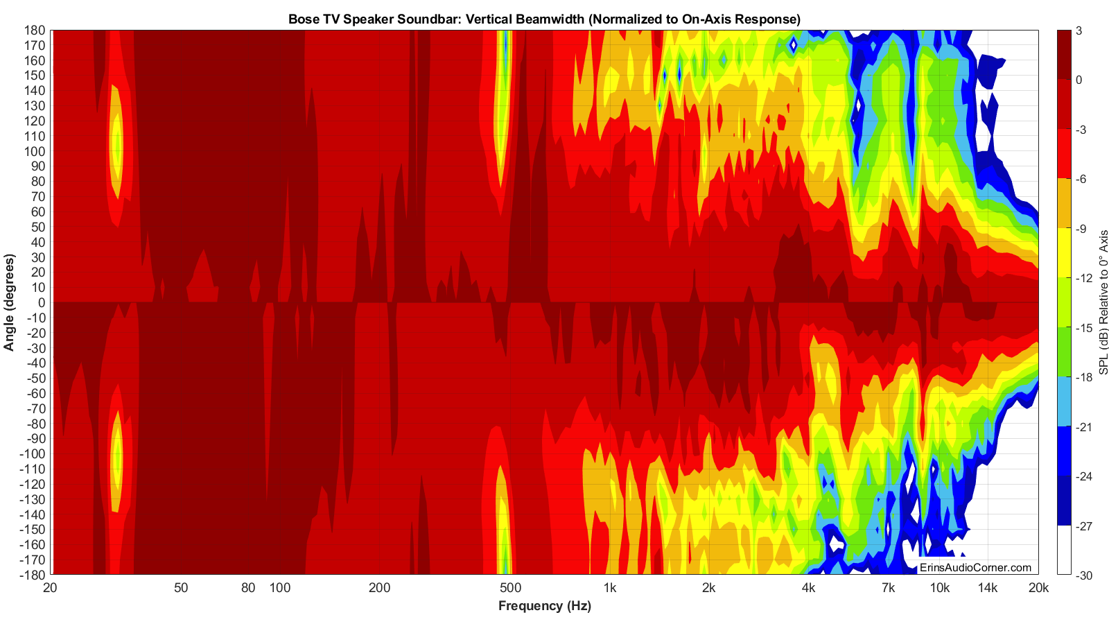

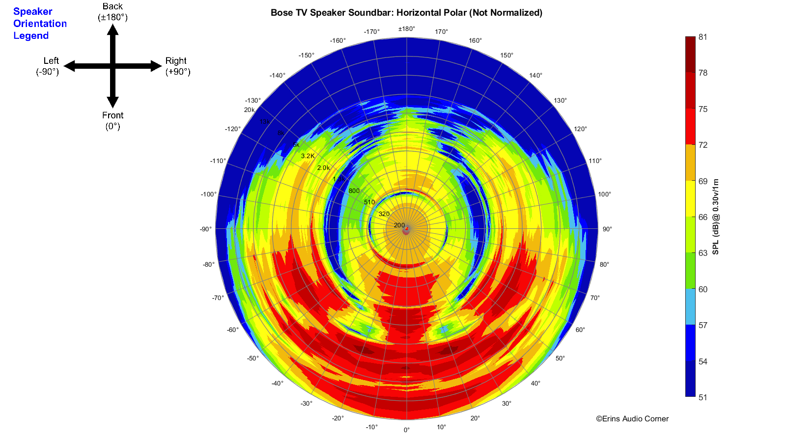

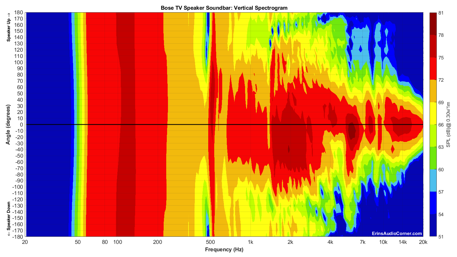

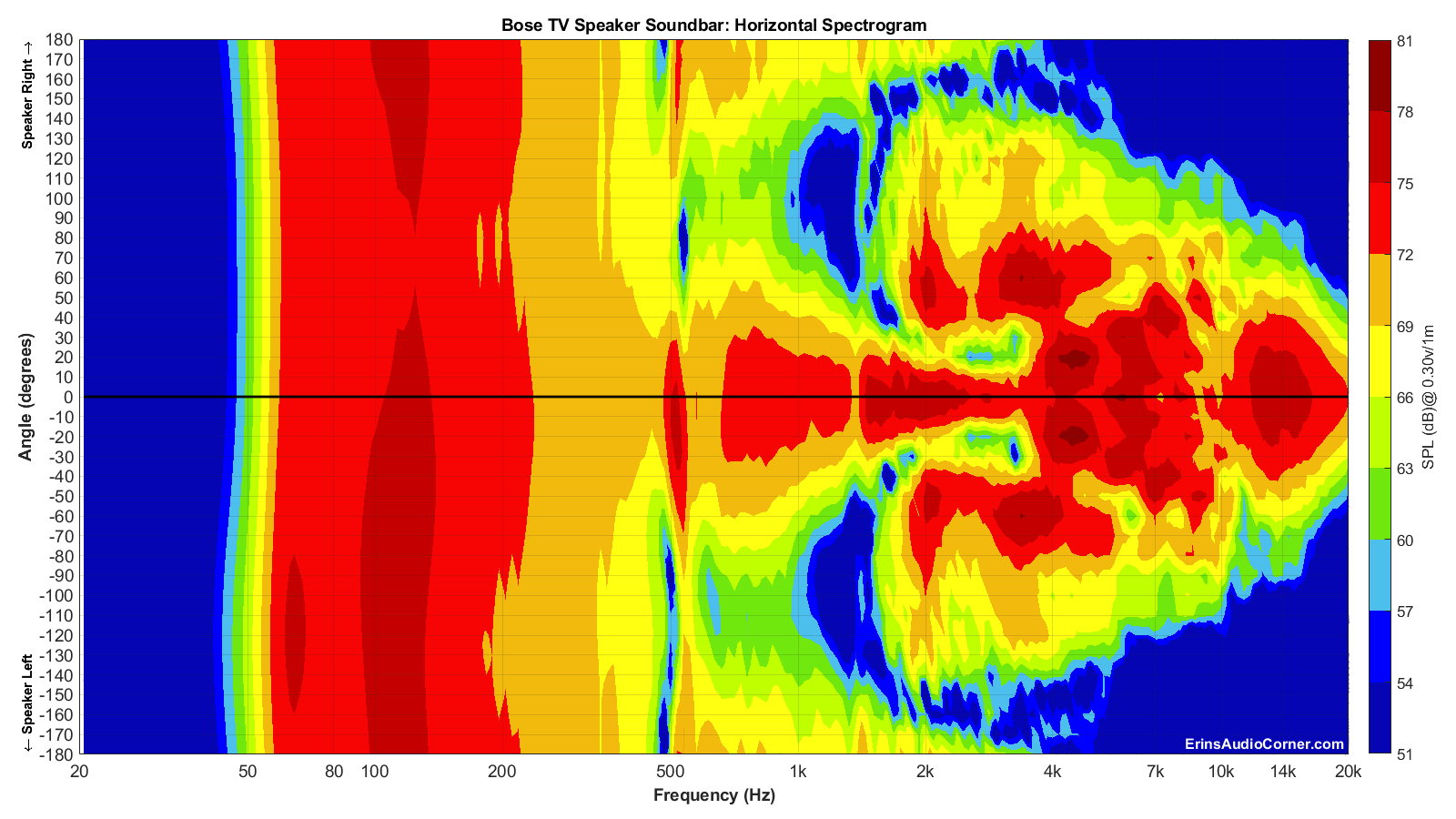

  • The horizontal radiation pattern shows a hole in response from about 10-30° between 800Hz to 2kHz. It almost seems as if it would be best to sit either dead on-axis or extremely far to the side (between 30 to 50°). One could easily have a different opinion depending on what frequency range and angle they are concerned with, however. No matter what, however, there is an undeniable drop in output (by about 30dB) right about 1300Hz to the side of the speaker and (as expected), there is not much output to the very rear. Still, there is a lot of sound energy spread by this speaker; however non-uniform it may be.
  • I’m surprised the horizontal radiation is so diffuse. I’d have expected this to behave much more like a true point-source given the close center-to-center spacing of the full-range drivers and the tweeter. There is a lot of cancellation in the 1300Hz region and I can’t imagine this is due to the tweeter (one would expect a tweeter of this size to be crossed much higher; especially since the side drivers are assumedly truly full-range or at least extend to the HF). Weird stuff.

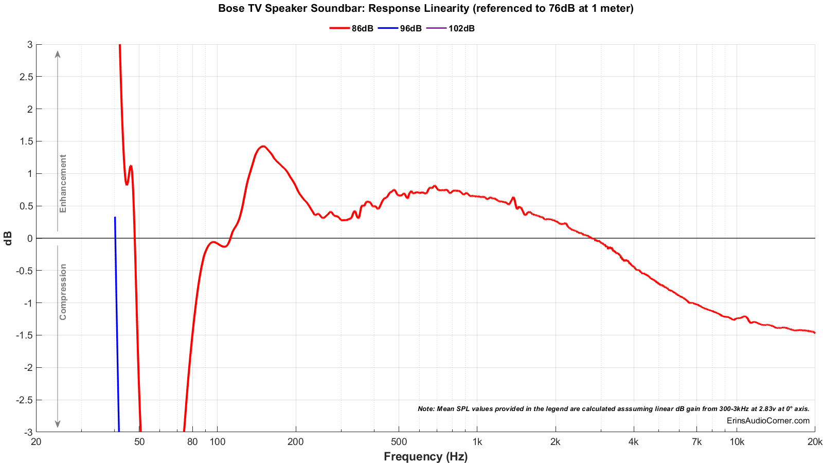

  • There is a significant level of limiting here. It registers off the chart, literally, from 76dB up to 86dB+. So, there is no doubt at all that this speaker incorporates some sort of loudness contour or something of the sort.
  • Dialogue mode makes a drastic effect but surprisingly it really only seems to just increase the level almost overall rather than enhancing a specific region (for example, a boost from 200-800Hz or 2-4kHz for detail).
  • Bass adjustment on this thing is also counterintuitive. In the max bass setting the difference between it and default is only up a dB or two below 100Hz. Above this frequency, however, both bass adjustment settings (max and min) are actually lower than the default. Odd.

Thanks for this! Very interesting to see. Tbh, this better than I expected (just a bit better lol). Surprised that the horizontal directivity is that bad though.

Most excellent work here, Erin. Bringing your insights to soundbars is an exciting development. Thank you. That said, those contour plots look like a Rorschach tests to me! Does it sound at all "froggy?" lol.
The frequency response is less broken than I expected. The compression tests are illuminating as always. I suppose one shouldn't expect more from tiny drivers in these things but I think if I were just a casual buyer I'd still be disappointed that my "expensive"(and yeah, for a lot of people $250 for a soundbar is expensive, particularly given how cheap TVs have gotten) dedicated audio solution can't even handle 86dB.
it’s not that it can’t handle 86dB. It’s just that the response changes drastically from 76dB to 86dB. the short term compression data shows us there is some sort of DSP going on to alter the response as the volume is increased.
These kind of results are a nice byproduct of the original intent of this test which was really intended to show instant compression but also works to show evidence of loudness contours, limiting, etc. :)
The mushroom cloud horizontal graph is a lot of fun :D

still pretty close fitting in a 6dB window, I expected worse actually. I'll be there are a ton of other soundbars that don't do as well. As a device that is a replacement for tv speakers, it could be good enough. Bose stuff tends to be overpriced but that's the Bose tax.....better sound through marketing
