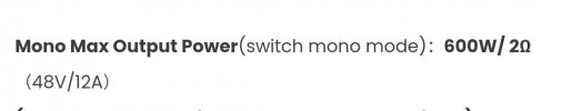

Most intriguing part of spec is this 600w/2ohm. Is that true?
