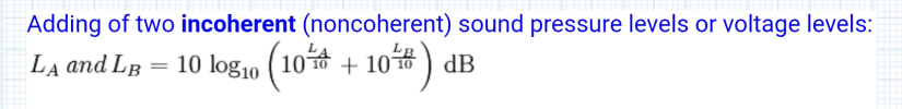

How then do you add them?
Here's the formula:
Source
And also I wonder if the characteristics (frequencies inherent) in the noise is uniform why you can't add the voltage after amplification?
Because the phase difference between the summands is random.
Here's the formula:
Source
Not to take this totally off topic, and thank you for nudging me in the right direction, but using this formula got me 4.8 uV for the two levels; 2.6 and 0.7 uV. After checking the formula in excel was okay I checked with this known page for all sorts of technical sound related stuff, which also gave 4.8 uV.
You got 2.7 uV.
Where's the mistake or misunderstanding?
You got 2.7 uV.
You are mixing up dB (which is a ratio) with voltages. The calculator only works for "adding" dB, not voltages.
Of course. Sqrt(2.6^2+0.7^2) = 2.7 uV. The formula stated voltage as well and got me confused there for a moment. It's of course referring to dBV with "voltage levels"..
@ you three distortion and noise adding experts (nice discussion btw.): If the power supply would have had less distortion at 60 Hz, 120 Hz, and 180 Hz - would the SINAD of the B100 be even better than 120 dB? I know, it’s only academically, because everything over 116 dB is fully transparent anyway, but if the power supply would have had the LA 90 48 Volt Power Supply-Qualities of minus 145 dB at 60 Hz:
the B100 would have killed the LA90 discrete by even more than 0.5 dB margin?
You got 2.7 uV.
You can't just input volts as though they were dB. Gotta convert it first.
