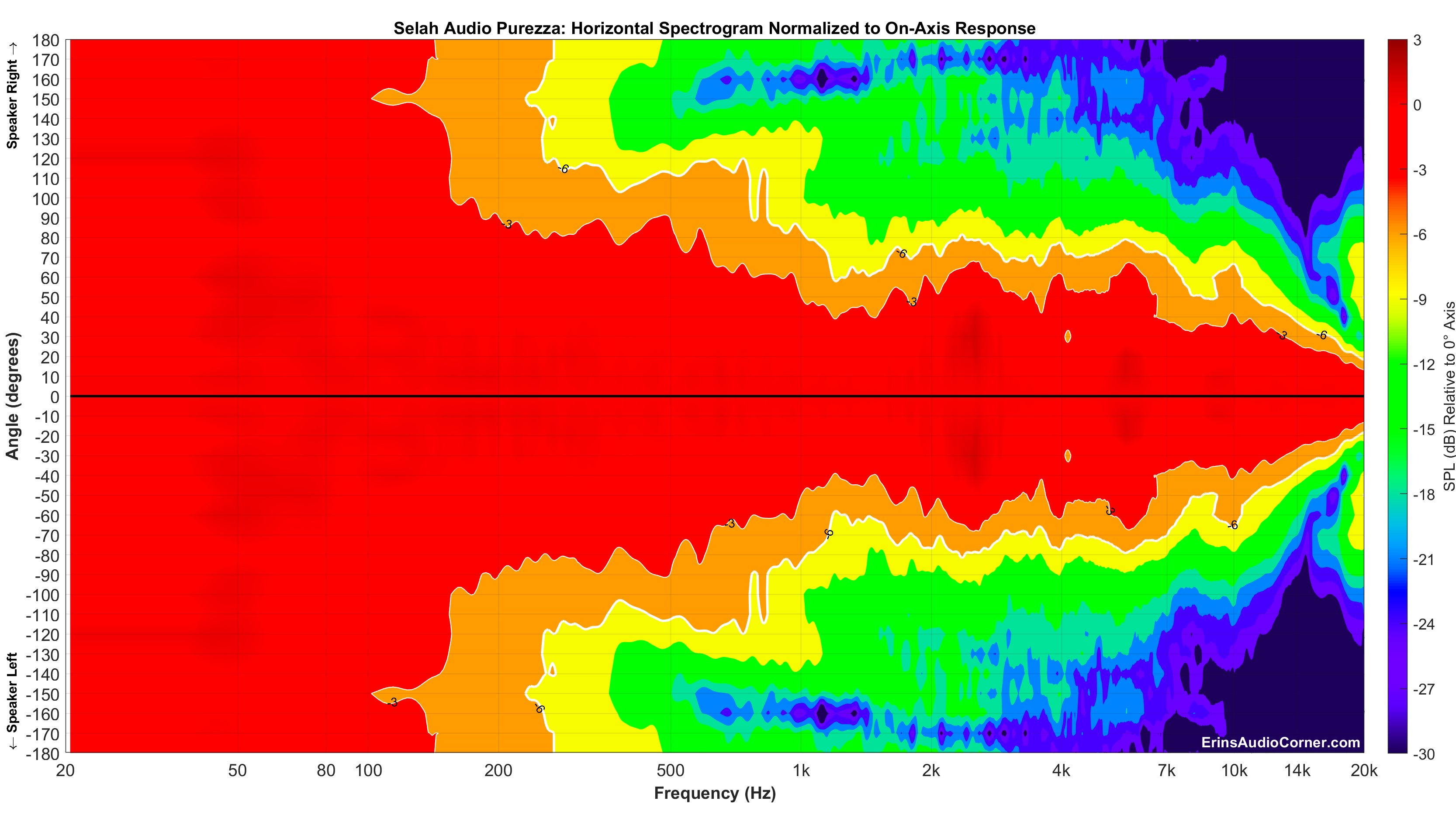

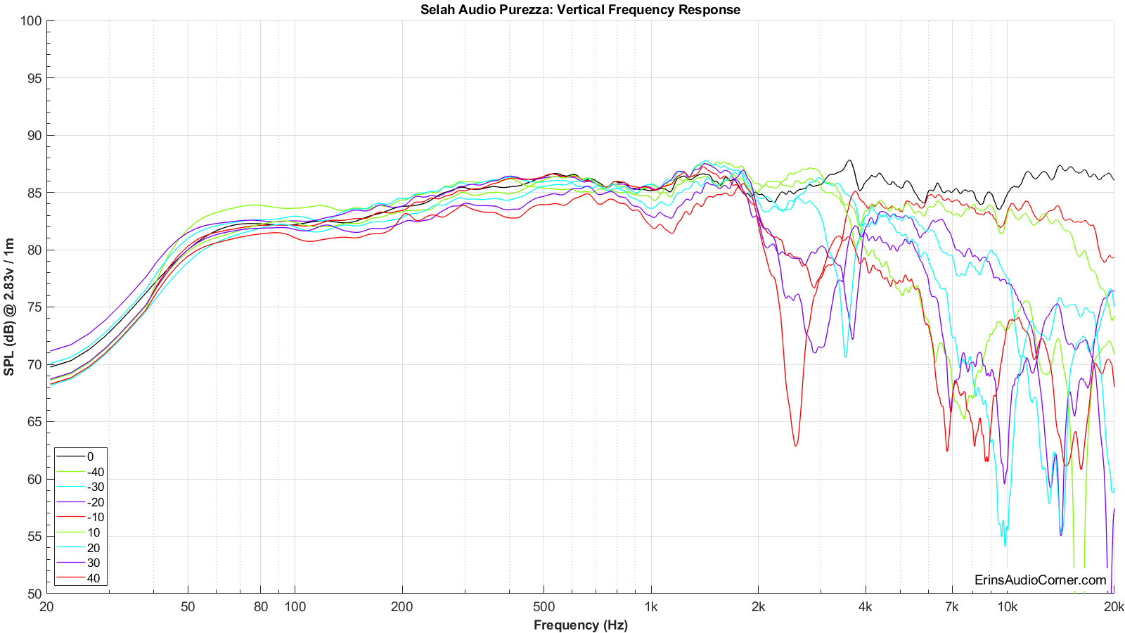

Below are both the horizontal and vertical response over a limited window (90° horizontal, ±40° vertical). I have provided a “normalized” set of data as well. The normalization simply means that I took the difference of the on-axis response and compared the other axes’ measurements to the on-axis response which gives the viewer a good idea of the speaker performance, relative to the on-axis response, as you move off-axis.
As I said above, the provided frequency response graphs were given with a limited set of data. I measured the response of the speaker’s vertical and horizontal axis in 10-degree steps over 360-degrees. Nearly 70 measurements in total are represented in my data. As you can imagine, providing all those data points in a single FR-type graphic below is a bit overwhelming and confusing for the viewer. A spectrogram is an alternate way to view this full set of data. This takes a 360-degree set of data and “collapses” it down to a rectangular representation of the various angles’ SPL. I have provided two sets of data: one set for horizontal and one for vertical. Each set consists of 2 graphics:
The above spectrograms are the standard way of providing directivity graphics by most reviewers. Some prefer not to normalize the data. Some prefer to normalize the data. Either way, it’s a useful visual to get an idea of the directivity characteristics of a speaker or driver.
However, these “collapsed” representations of the sound field are not very intuitively viewed. At least not to me. So, I came up with a different way to view the speaker’s horizontal and vertical sound field by providing it across a 360° range in a globe plot below. I have provided both an absolute SPL version as well as a normalized version of both the horizontal and vertical sound fields.
Note the legend provided in the top left of each image which helps you understand speaker orientation provided in my global plots below.

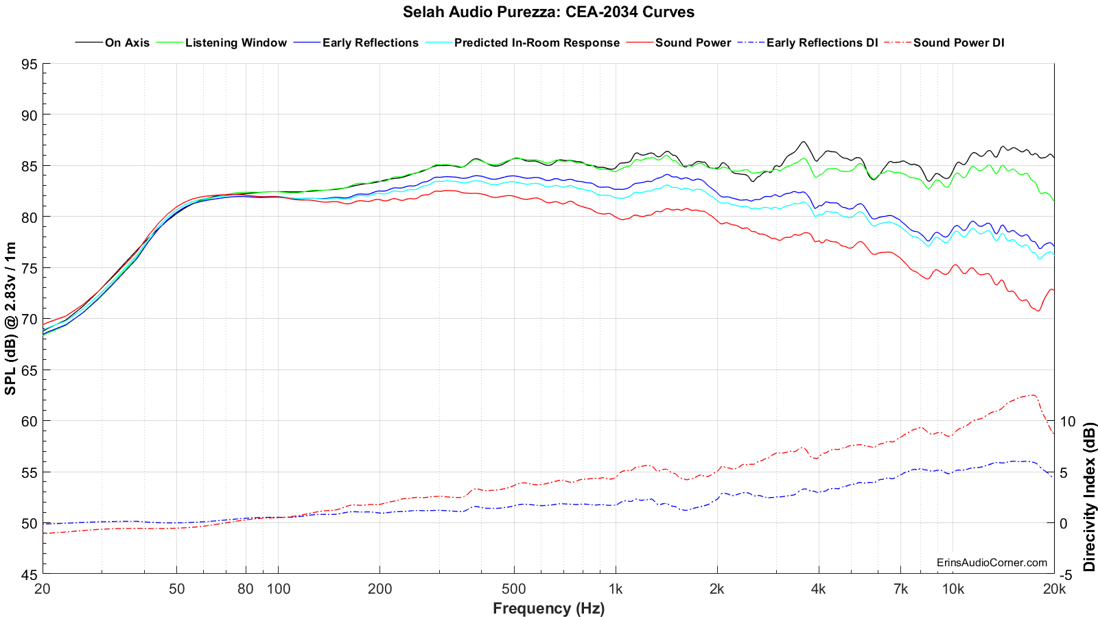

CEA-2034 (aka: Spinorama):
The following set of data is populated via 360-degree, 10° stepped, “spins” from vertical and horizontal planes resulting in 70 unique measurements. Thus, this is sometimes referred to as “Spinorama” data. Audioholics has a great writeup on what these data mean (link here) and there is no sense in me trying to re-invent the wheel so I will reference you to them for further discussion. However, I will explain these curves lightly and provide my own spin on what they mean (pun totally intended). Sausalito Audio also has a good write-up on these curves here. Furthermore, you can find discussion in Dr. Floyd Toole’s book “Sound Reproduction”. And, finally, here is a great video of Dr. Toole discussing the use of measurements to quantify in-room performance.
In short, the CEA-2034 graphic below takes all the response measurements (horizontal and vertical) and applies weighting and averaging to sub-sets and can help provide an (accurate) prediction of the response in a typical room. If there is a single set of data to use in your purchase decision, this is probably it.
Alternatively, click this arrow, if you want my quick take on what these curves mean without going to another site.
Below is a breakout of the typical room’s Early Reflections contributors (floor bounce, ceiling, rear wall, front wall and side wall reflections). From this you can determine how much absorption you need and where to place it to help remedy strong dips from the reflection(s). Again, as a pointer to the wide horizontal envelope, notice how the Rear Wall Bounces Curve is relatively high in amplitude (for a front-facing tweeter, at least) until about 10kHz.

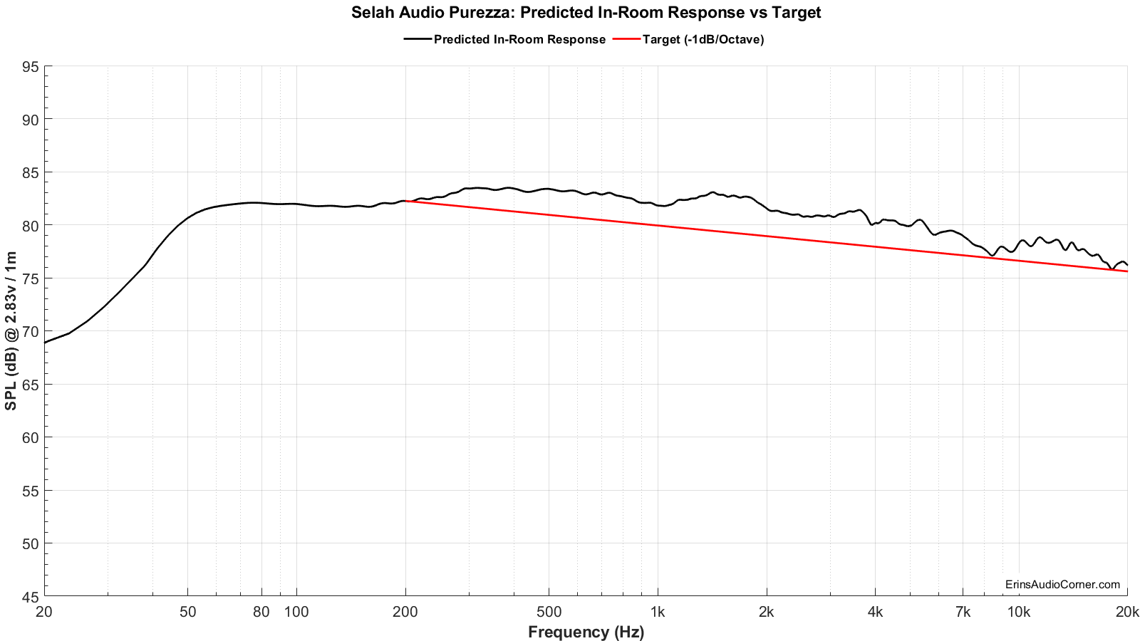

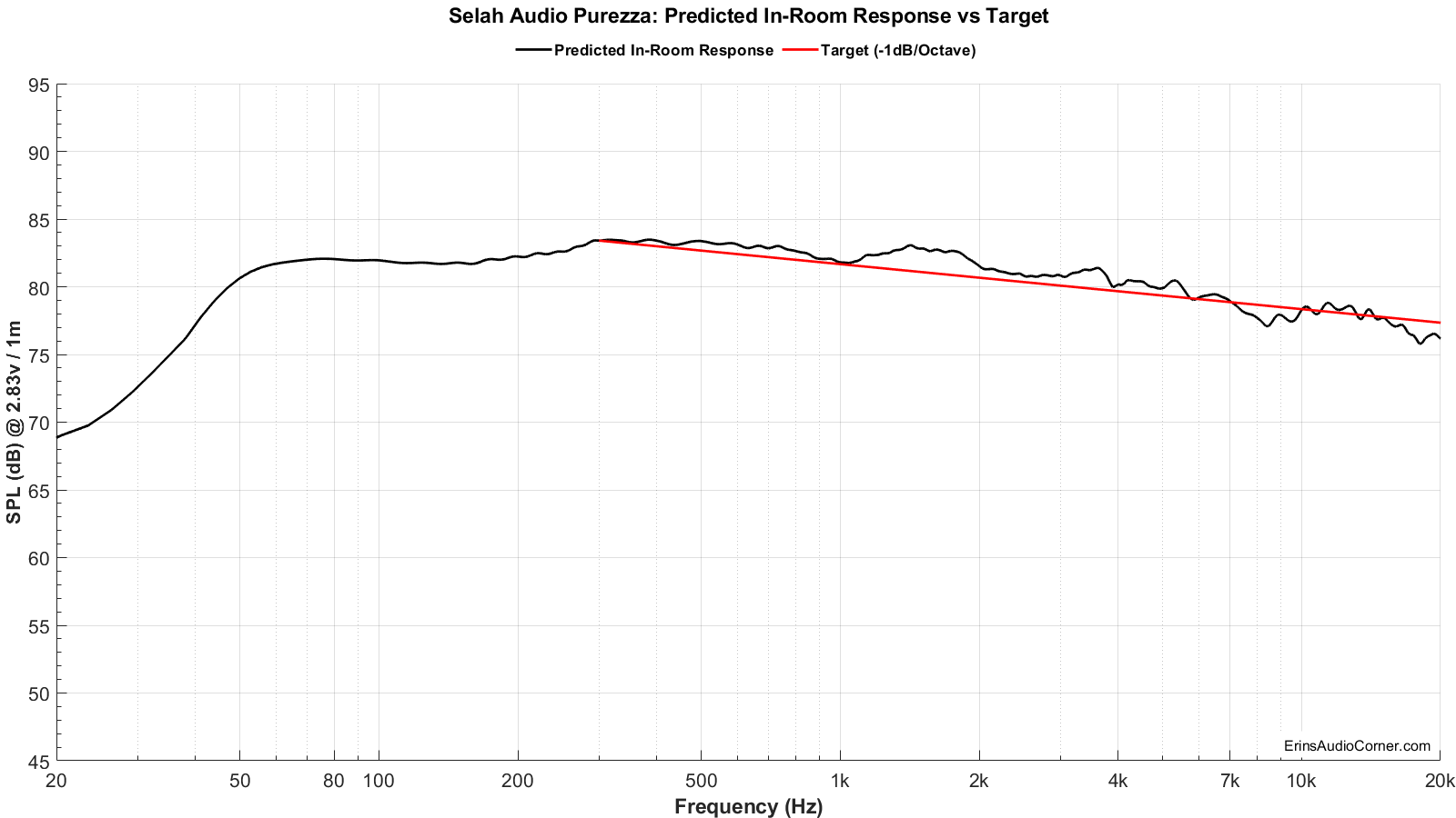

And below is the Predicted In-Room response compared to a general Target curve equaling -1dB/octave.
The placement of the target curve’s starting point at 200Hz (which is my standard) combined with the previously discussed low-frequency trim of 2.5dB, makes the difference between the target curve and predicted in-room response more apparent than I suspect would actually be. So, I have also provided another version of this image below, using 300Hz as the starting point.
You may ask just how useful the above prediction is. Well, I’d be remiss for not delving in to that a little bit here. Please see my Analysis section below for discussion on this.

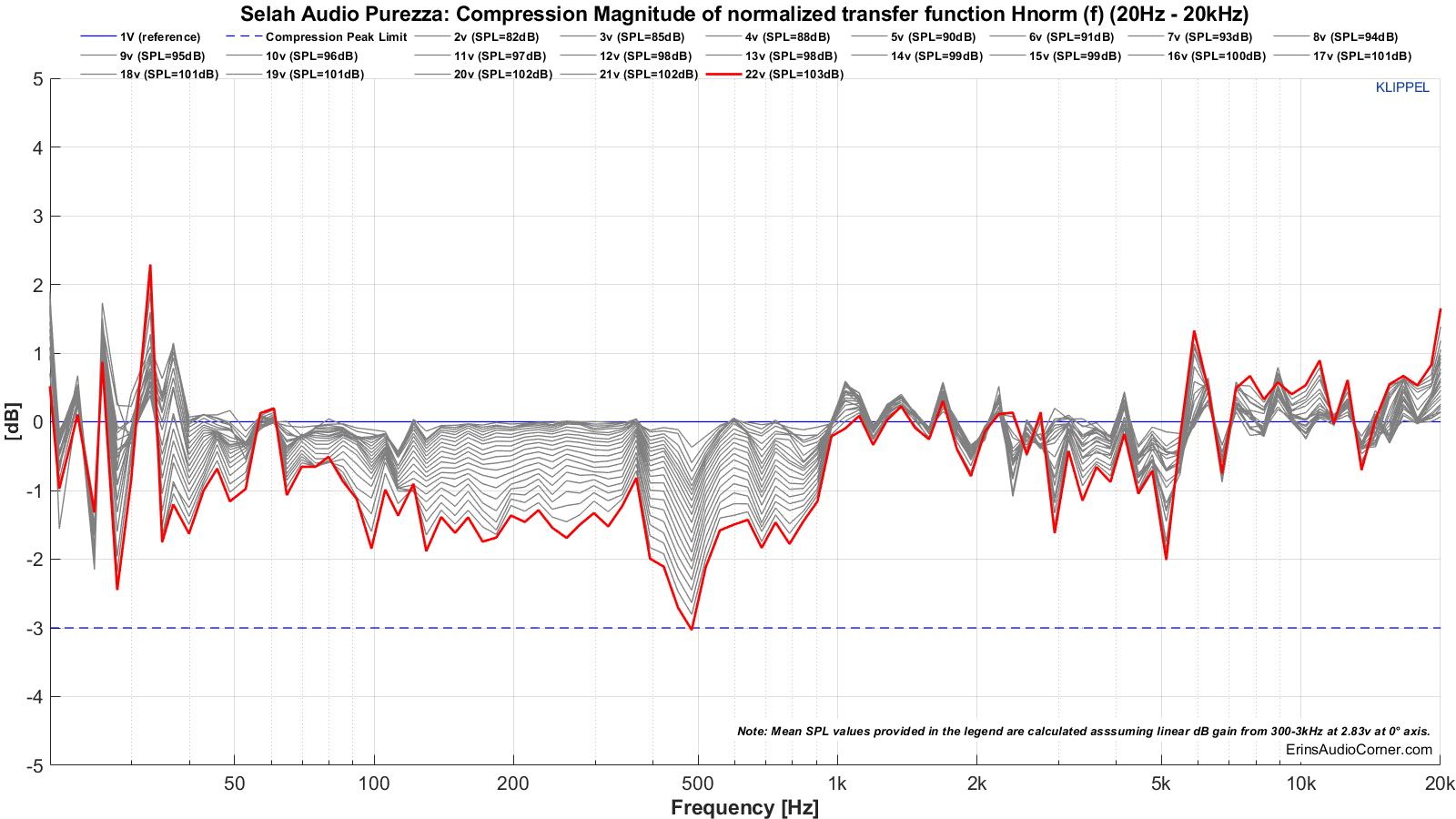

Maximum Long Term SPL:
The below data provides the metrics for how Maximum Long Term SPL is determined. This measurement follows the IEC 60268-21 Long Term SPL protocol, per Klippel’s template, as such:
The thresholds to determine the maximum SPL are:
This measurement is conducted twice:
You can watch a demonstration of this testing via my YouTube channel:
Test 1: 20Hz to 20kHz
Multitone compression testing. The red line shows the final measurement where either distortion and/or compression failed. The voltage just before this is used to help determine the maximum SPL.
Multitone distortion testing. The dashed blue line represents the -20dB (10% distortion) threshold for failure. The dashed red line is for reference and shows the 1% distortion mark (but has no bearing on pass/fail). The green line shows the final measurement where either distortion and/or compression failed. The voltage just before this is used to help determine the maximum SPL.

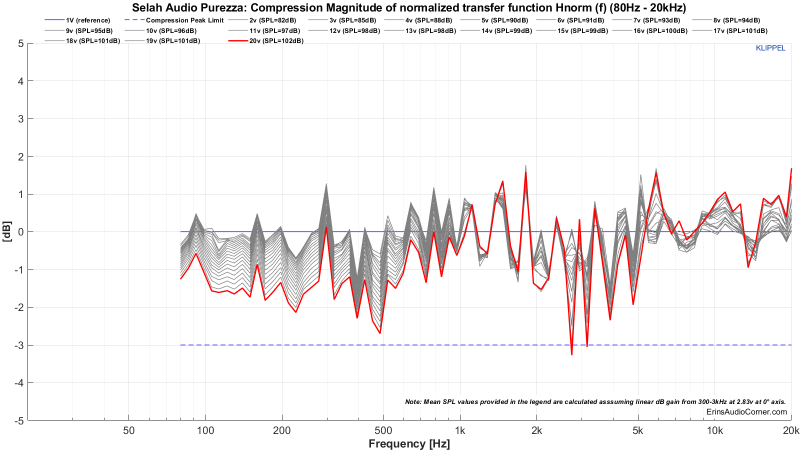

Test 2: 80Hz to 20kHz
The above data can be summed up by looking at the tables above but is provided here again:

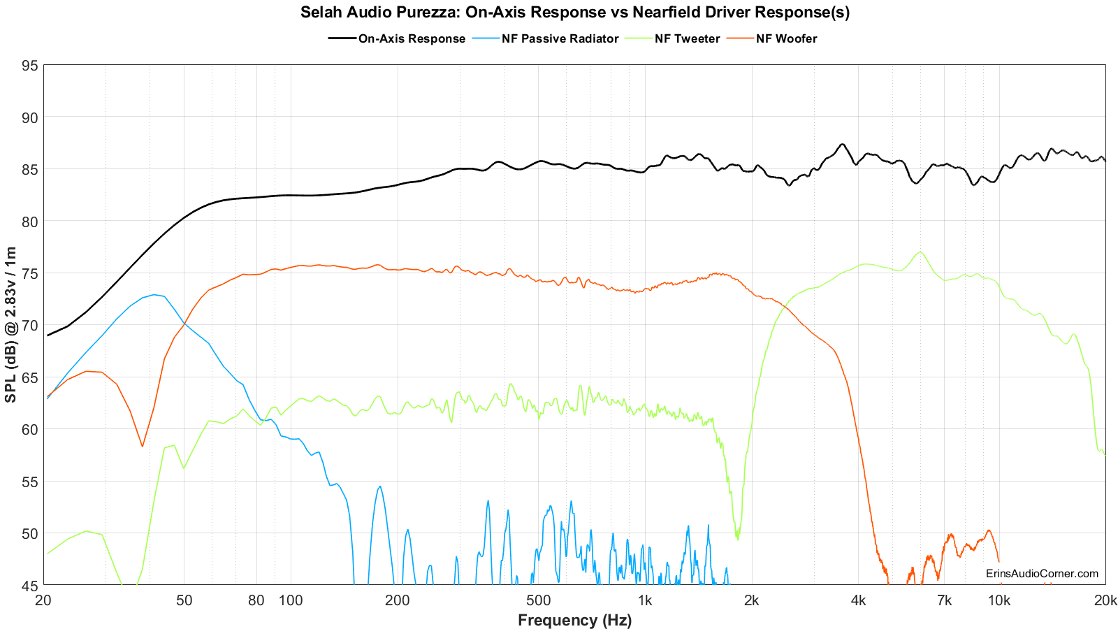

Nearfield measurements.
Mic placed about 0.50 inches - relative to the baffle - from each drive unit and port. While I tried to make these as accurate in SPL as I could, I cannot guarantee the relative levels are absolutely correct so I caution you to use this data as a guide but not representative of actual levels (measuring in the nearfield makes this hard as a couple millimeters’ difference between measurements can alter the SPL level).
Notice how there is no resonance in the nearfield measurements. It’s not at all unusual to see port resonance or woofer resonance outside the crossover; these issues tend to creep up as distortion (linear and non-linear) in the speaker evaluation. However, there is none of that here.

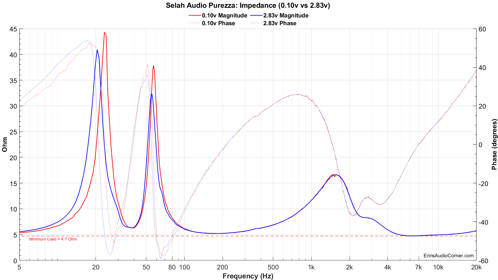

Impedance Phase and Magnitude:
Impedance measurements are provided both at 0.10 volts RMS and 2.83 volts RMS. The low-level voltage version is standard because it ensures the speaker/driver is in linear operating range. The higher voltage is to see what happens when the output voltage is increased to the 2.83vRMS speaker sensitivity test.
From the above data we can see the following:
- The tuning frequency of the enclosure is approximately 35Hz.
- The minimum impedance dips to about 4.7 Ohms around 1.4kHz with a nominal impedance at 5 Ohms. A separate amplifier from the typical AVR would be needed to drive this speaker to typical playback volumes.
- There are no signs of resonance (typically visible as bumps/wiggles in the impedance that deviate from the curve).

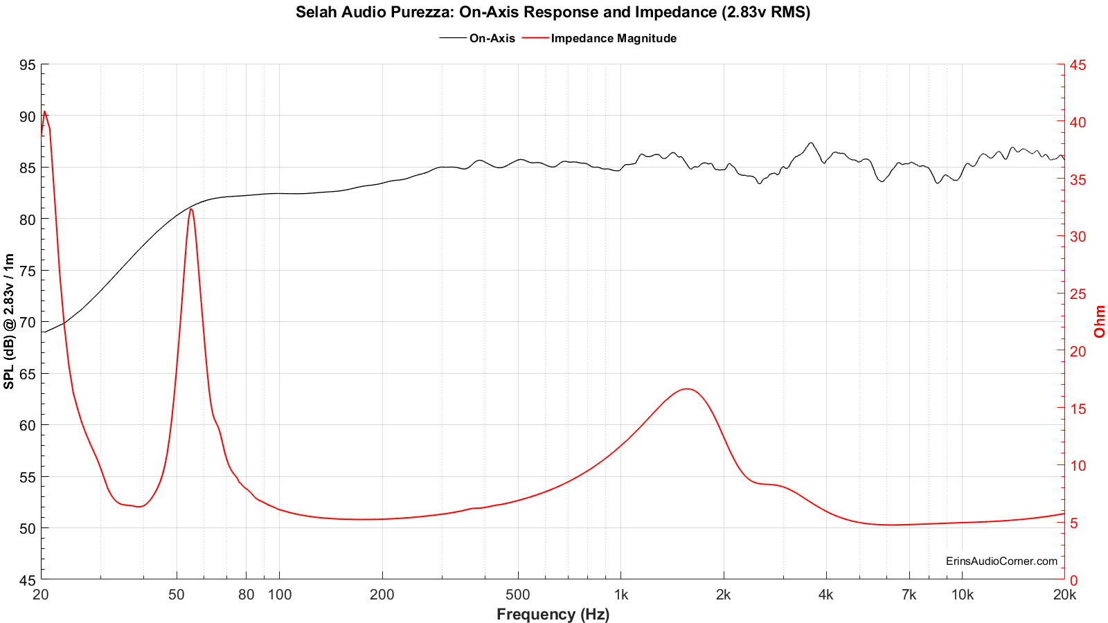

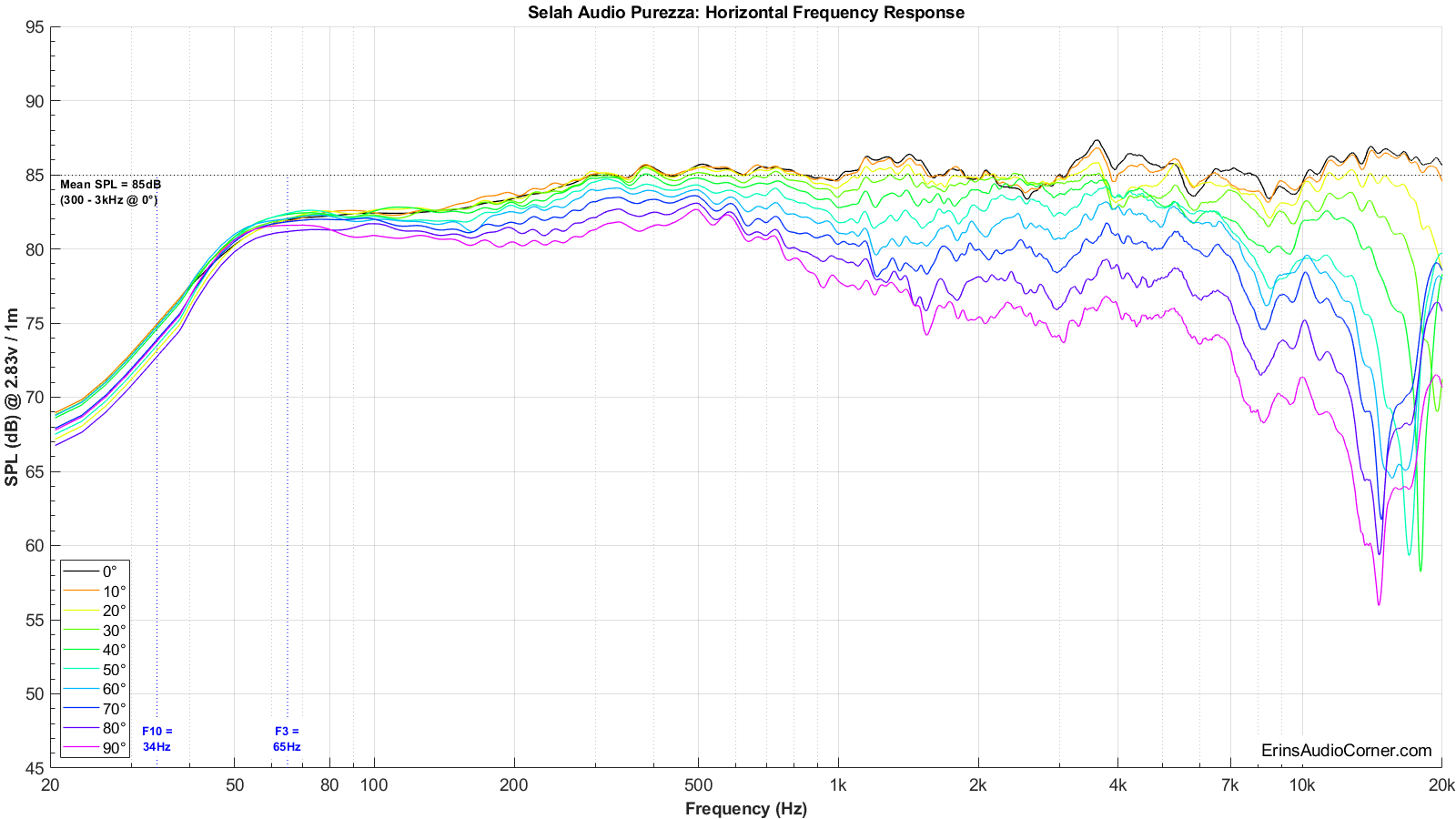

Frequency Response:
Notes about measurements (click for info)
The measurement below provides the frequency response at the reference measurement axis - also known as the 0-degree axis or “on axis” plane - in this measurement condition was situated at the ribbon.
The mean SPL, approximately 85dB at 2.83v/1m, is calculated over the frequency range of 300Hz to 3,000Hz.
The blue shaded area represents the ±3dB response window from my calculated mean SPL value. As you can see in the blue window above, the Selah Audio Purezza has a ±3dB response from 65Hz - 20kHz. Even better, a tighter window of linearity is provided in gray as ±1.5dB from the mean SPL and this speaker stays within this window from about 200Hz all the way to 20kHz (ignoring the 0.5dB around 3.7kHz). That is impressive!
The speaker’s F3 point (the frequency at which the response has fallen 3dB relative to the mean SPL) is 65Hz and the F10 (the frequency at which the response has fallen by 10dB relative to the mean SPL) is 34Hz. This speaker has nice low frequency extension.
You will most likely be drawn the low-frequency trim below ~300Hz, showing about 2.5dB drop from 300Hz to 100Hz. I asked Rick about this and this was his reply:
The amount of baffle step compensation was determined from how I thought most users would place the speaker (in close proximity to the rear wall). I could easily change the BSC if someone places it far out into the room and / or wants it voiced differently. There’s always the tradeoff of output capability / sensitivity in the midband and I wanted to keep the sensitivity more reasonable. The tuning is also slightly overdamped which contributes to what you measured as well.
So, Rick can adjust this amount of trim or you can use a DSP shelf-filter to boost this back up. Personally, in my initial listening tests I actually really, really liked the bass. But I wound up employing DSP to boost the LF to get it to a more accurate setting. I will discuss this more in the subjective evaluation below and give some of my thoughts on this.
Another thing that stood out to me was the lack of midrange resonance I measured in Buchardt's S400 speaker and that I believe I have seen in other speakers using a passive radiator in the rear.

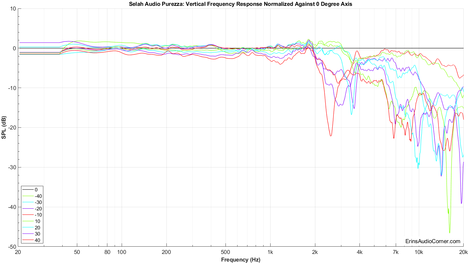

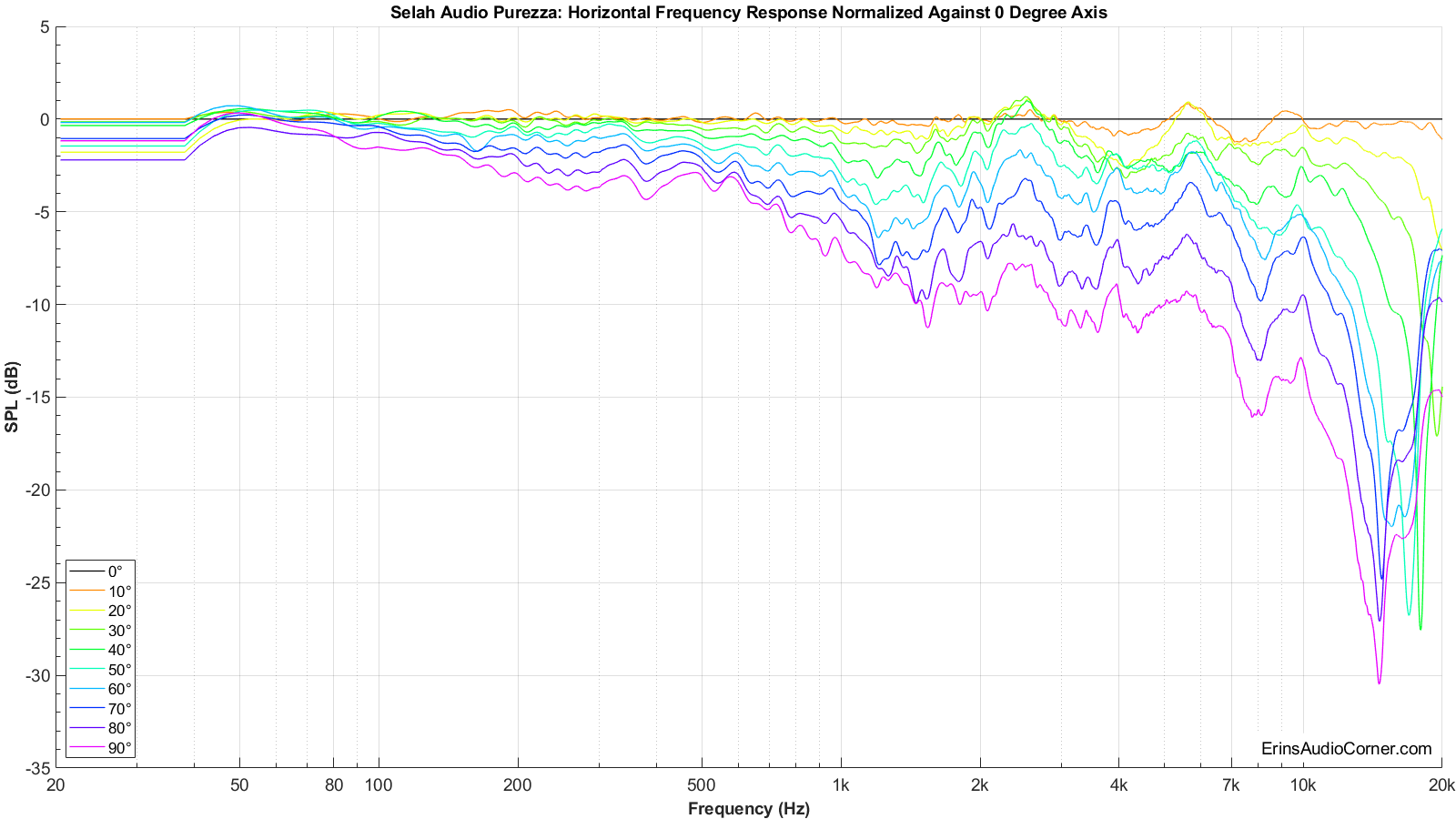

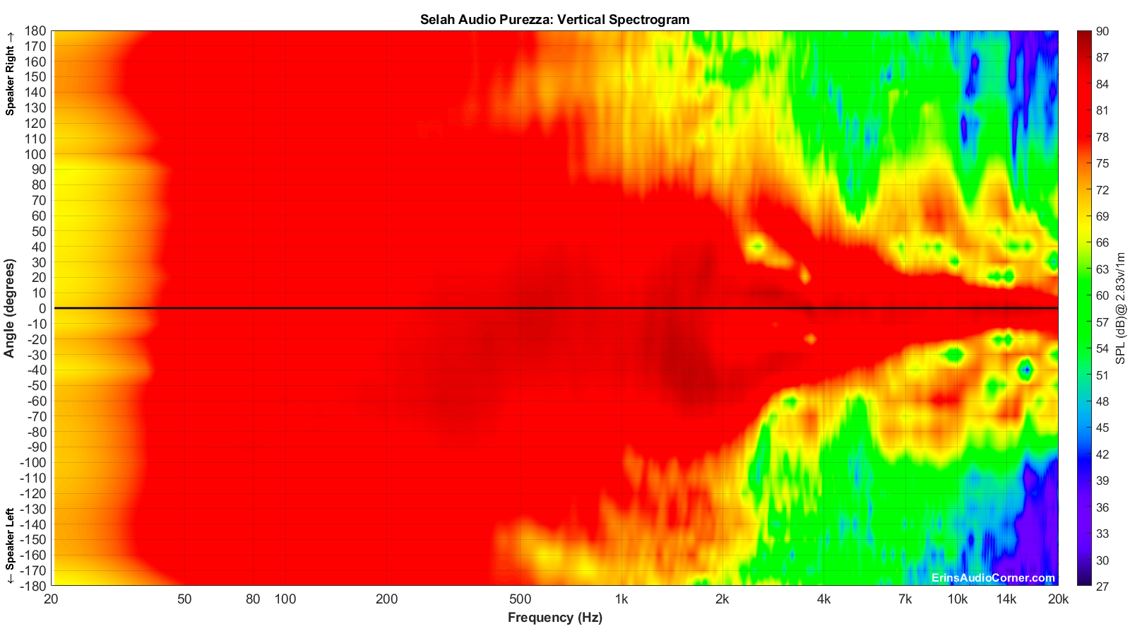

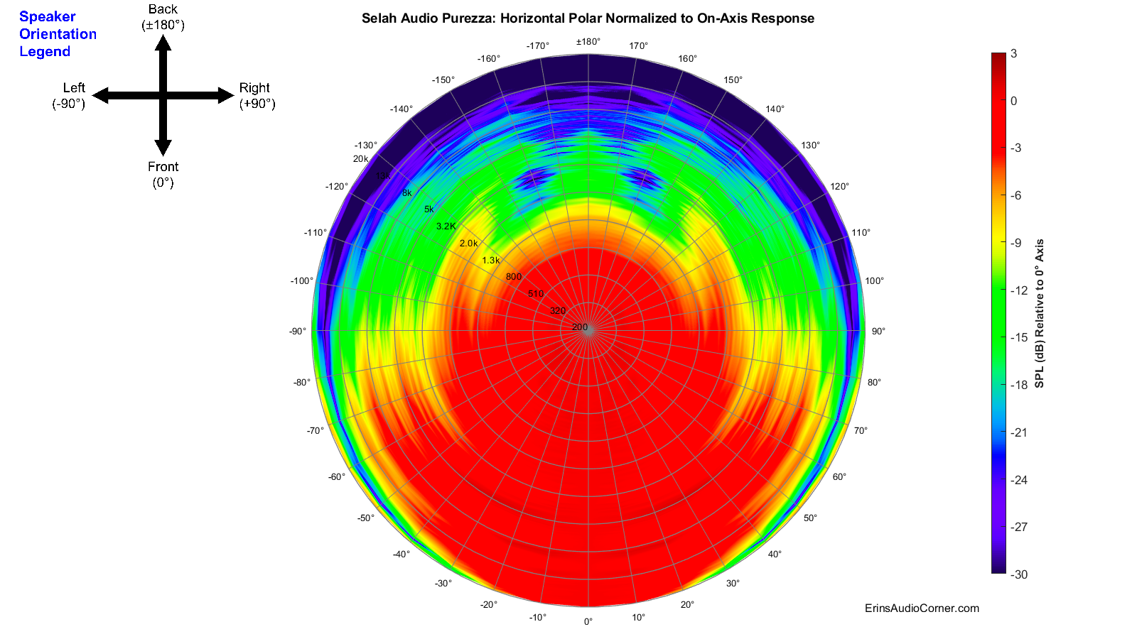

- Full response (20Hz - 20kHz with the angles from 0° to ±180°) with absolute SPL values
- Full, “normalized” response (20Hz - 20kHz with the angles from 0° to ±180°) with SPL values relative to the 0-degree axis

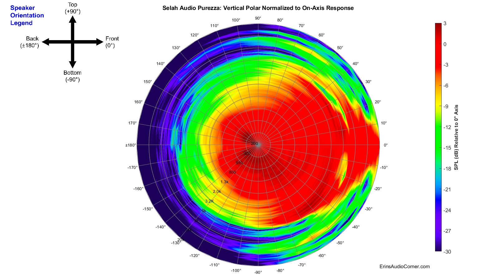

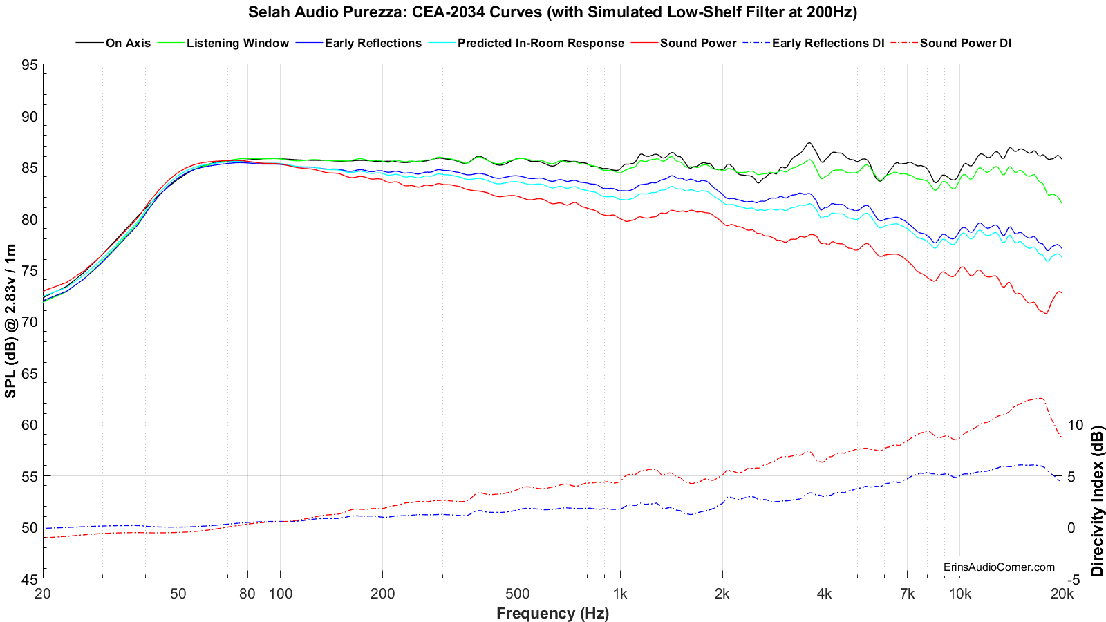

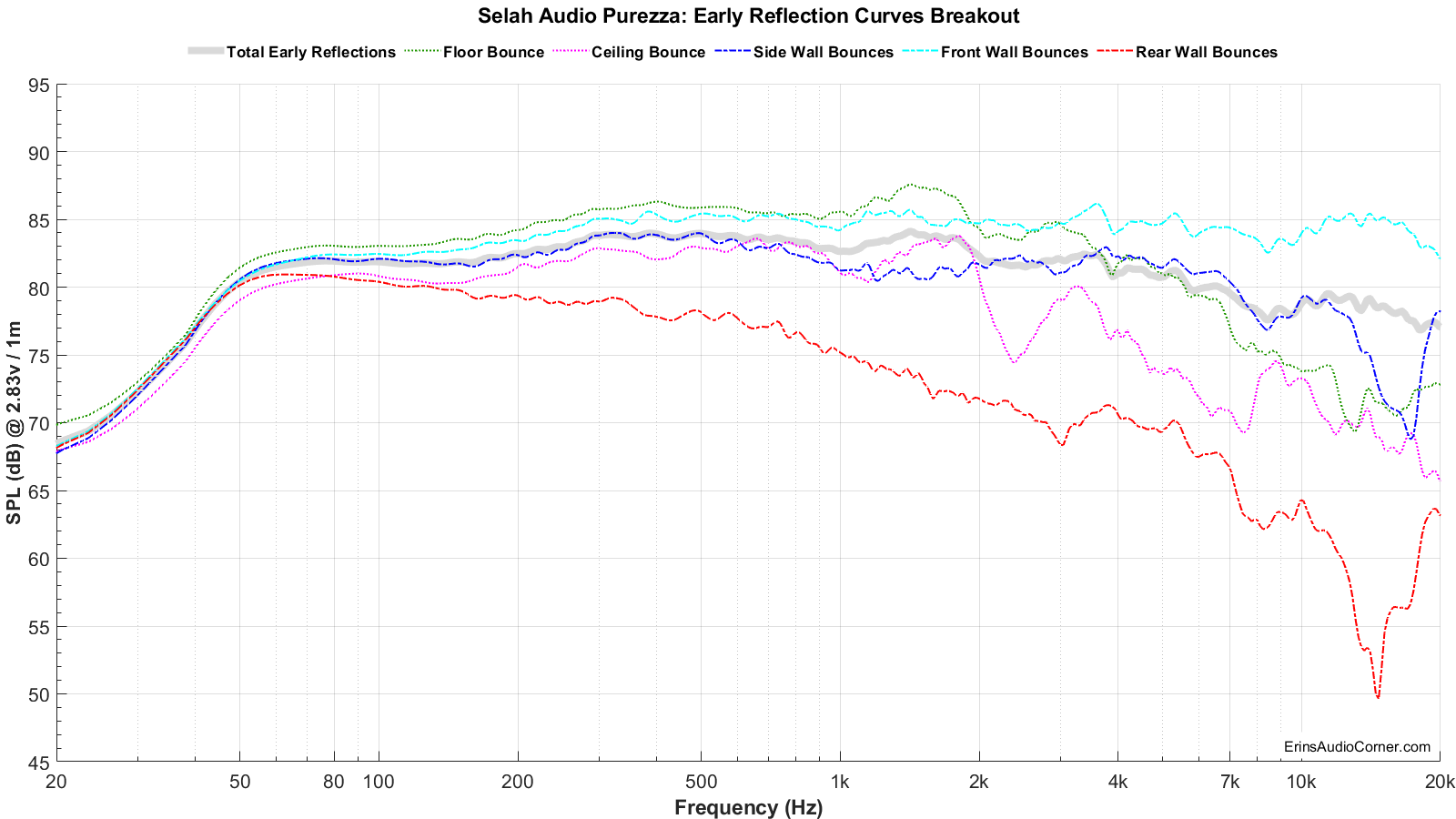

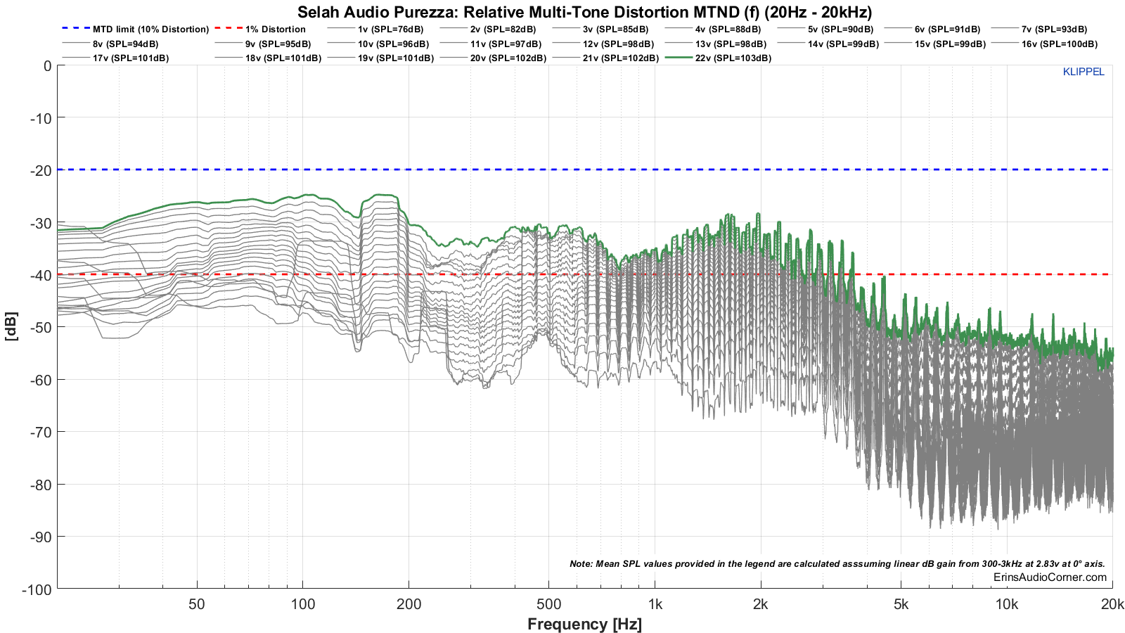

- Rated maximum sound pressure according IEC 60268-21 §18.4
- Using broadband multi-tone stimulus according §8.4
- Stimulus time = 60 s Excitation time + Preloops according §18.4.1
- -20dB Distortion relative to the fundamental
- -3dB compression relative to the reference (1V) measurement
- First with a 20Hz to 20kHz multitone signal
- Second with a limited 80Hz to 20kHz signal
- Max SPL for 20Hz to 20kHz is approximately 103dB @ 1 meter. The compression threshold was exceeded above this SPL.
- Max SPL for 80Hz to 20kHz is approximately 102dB @ 1 meter. The compression threshold was exceeded above this SPL.

Simulated Response Using Low-Shelf Filter at 200Hz.
Given the LF trim of this speaker, I decided to see what a simple low-shelf filter would do in order to correct the response and flatten it. Think of this as a ‘tonal contour’. I applied a single low-frequency shelf at 200Hz with a gain of 3.5dB and a Q of 0.70 to arrive at the below CEA-2034 response curve set.
As you can see, the response is incredibly smooth and flat wtih this single band of EQ applied. I discuss my subjective impressions of this adjustment in the subjective evaluation section below.

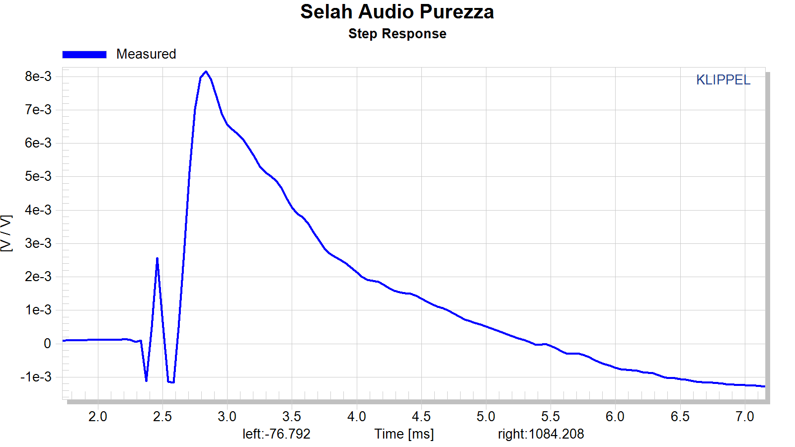

Step-Response.

Below is the measured in-room response at the main listening position (MLP) in blue, across the front row of seats (red) both compared against the predicted in-room response (black). You can see the prediction follows pretty reasonably to what is measured in the seated position, aside from the major modal dip at ~125Hz and the dip between 2-3kHz.
The measurements/prediction below do not have EQ applied.
