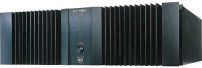

Maybe someday a Rotel class-D amplifier will find the way to Amir

When you can snag an Hypex NC252MP amp (with 12v trigger), for US$625 the Rotel for $500 looks lackluster for sure -- much higher noise and distortion.
For those that admit the sonic differences can exist between amplifiers, the distortion + noise spectrum for Rotel suggests that won't sound "harsh" but that it won't sound as detail or transparent as, say, a Hypex, and that it might sound a bit "grainy" -- granted, that will only be evident of one's associated equipment is very good quality.

Warning: this device doesn't have a relais to disconnect your expensive speakers in the case of an DC-error or a short-circuit in the output-stage! It has an over-temperature protection. In the case of over-current from an output, fuses will blown. But thats a risk for getting DC on an output.
I have to say i don't like Rotel in general. The cases may be good, but i don't like to see schematics, where the component count was reduced to an extreme level. Here are even protective base resistors missing. Such parts costs just a few cents?!
