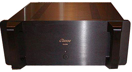

I remember testing this amp against Classé CA-200, with Wilson Audio Maxx speakers.
