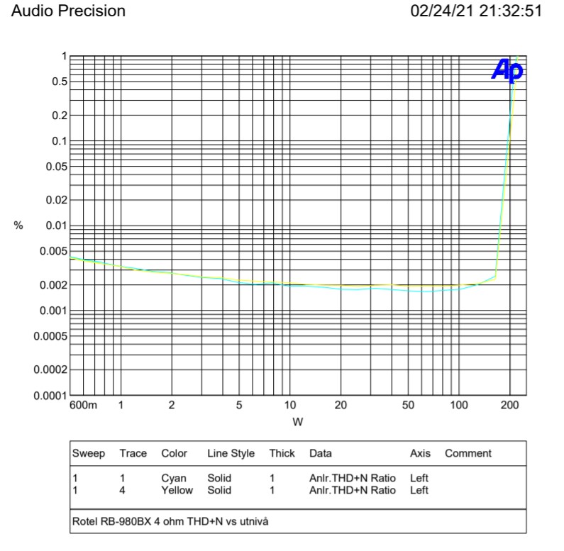

Have you looked at the two images I posted???
You posted 2 different graphs, the lower one is not ventilated with frequencies. I believe the main point of Thomas is the absence of frequency dependencies in THD spec. Which indeed is a bit more of the norm in class AB. It doesn't mean that I don't agree with your main point but let's compare graphs that evaluate the same metrics, else we confuse everything.
You mean this one?
Yes, I looked at that one. The comparison would be to this one of an old Rotel model (980BX this time but 980BX-981-1070 are basically the same with slight modifications over the years):
file.php
Amirs measurements of the RB-1070 is basically flat on the 0.01% line. (Reasons could be aging caps.) Despite that there was no rising distortion vs. frequency when power increased.
