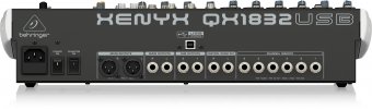

Hi everybody, need a bit of help… I’ve got a Behringer QX1832USB Mixer at home, all my 6 x keyboards go into it in STEREO, then from the desk it goes into my Yamaha HS7 Speakers, no matter what EQ settings I try and play with on the desk, my Korg Kronos and Yamaha Montage (when playing pianos) sound awful!! Speakers sound Sort of honky and boxy sounding, I’ve no idea if it’s the speakers I need to sell or the desk and get someat else? anyone had the HS7 speakers and found a similar issue? When I put headphones on and play my keyboards it sounds amazing! Racking my brains trying to figure this out when I see demos of these keyboards on YouTube, mine do not sound like that ‍♂️♂️
Maybe I just need to sell these speakers and get another make and model?
I’m using balanced cables
