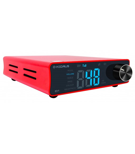

From the back of my D3 it appears they intend to use the same case/part for the D1 D2 and D3
Both D1 and D3 have vents on sides and bottom, please see the pictures I have added.
Daam i totally missed it
Is it enough ?
Is it enough ?
I think so, unless pushed massively hard for its caliber.
Metal heatsink is screwed to the bottom of the case, so case itself becomes responsible for cooling the chip.
Vents are there for the rest.

o-noorus question , is the volume reversed or is the picture reversed (mirror image)
