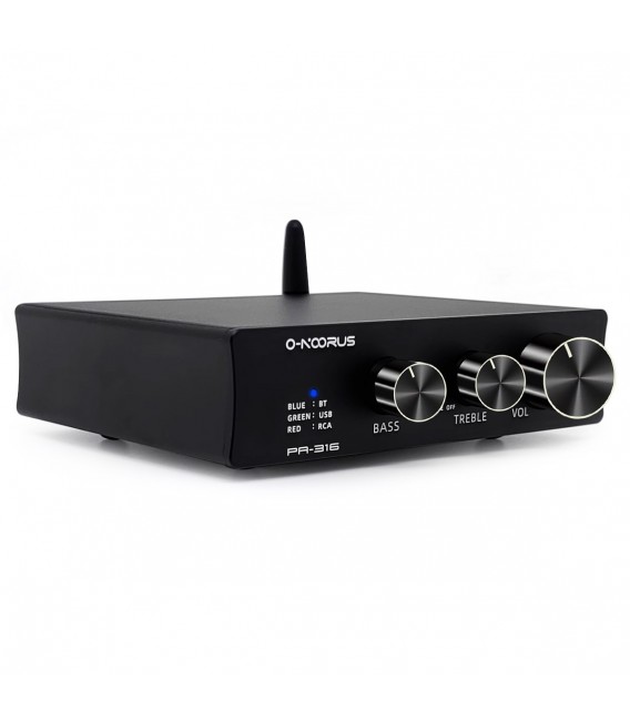

O-NOORUS often has has 2 inputs, one analog and one usb, can usb handle highest non mqa quality from tidal (i think highest normal quality is 24 bit and 96khz)
Im interested in a PA-316 and a PA70 (pa70 has no heatsink, will that be a problem ?)
They both have 2 inputs + sub out, one for my pc and one for my source selector, for my cdplayer, tt and tape deck,bass is left treble is right,bluetooth and a 24 volt not 4.5 a psu but 24 volt and 6.5 a psu, it costs under 100 euros with shipping
MA12070 or other Infineon chips have been implemented without heatsink by almost every manufacturer. I think I read somewhere that Infineon have mentioned that it doesn't need one.
I would be scared to use one at high levels (even when i did have one)
It’s not difficult to just put a small heat sink on the chip directly if dismantling case isn’t an issue.
Official 16bit 48K is max from the usb of a O-NOORUS PA-316 and guess also the PA-70
The 12070 will make more heat at any load above 2.5W than the 3116D2 with both running on a 24V supply due to lower efficiency. Power in = (Power out / Efficiency %)
#1220
Ordered the O-NOORUS PA-316 to get usb in (direct from my pc 16 bit 48khz, not first to source selector) line in for the rest (source selector, then line in), (sub out is there in case i need it), bass left , treble right, 24 volt 6.5 a psu not 24volt and 4.75 a, less heat above 2.5 watt compared to a ma 12070 based amp + im pretty shure it has a heatsink.price with 2-5 day standard delivery 84 euros total using paypal (said 80.72 but total a little extra,taxes,vat what ever)
A pffb design with plenty of power, a sub crossover, power-amp function and a remote at that price.. sounds like a bargain to me. The price is so low it makes me think have some corners been cut, but having seen a few photos of the innards it seems ok I think.
Wonder if there's a signal sensing auto-on/off function when used as a power amp (BP mode).
