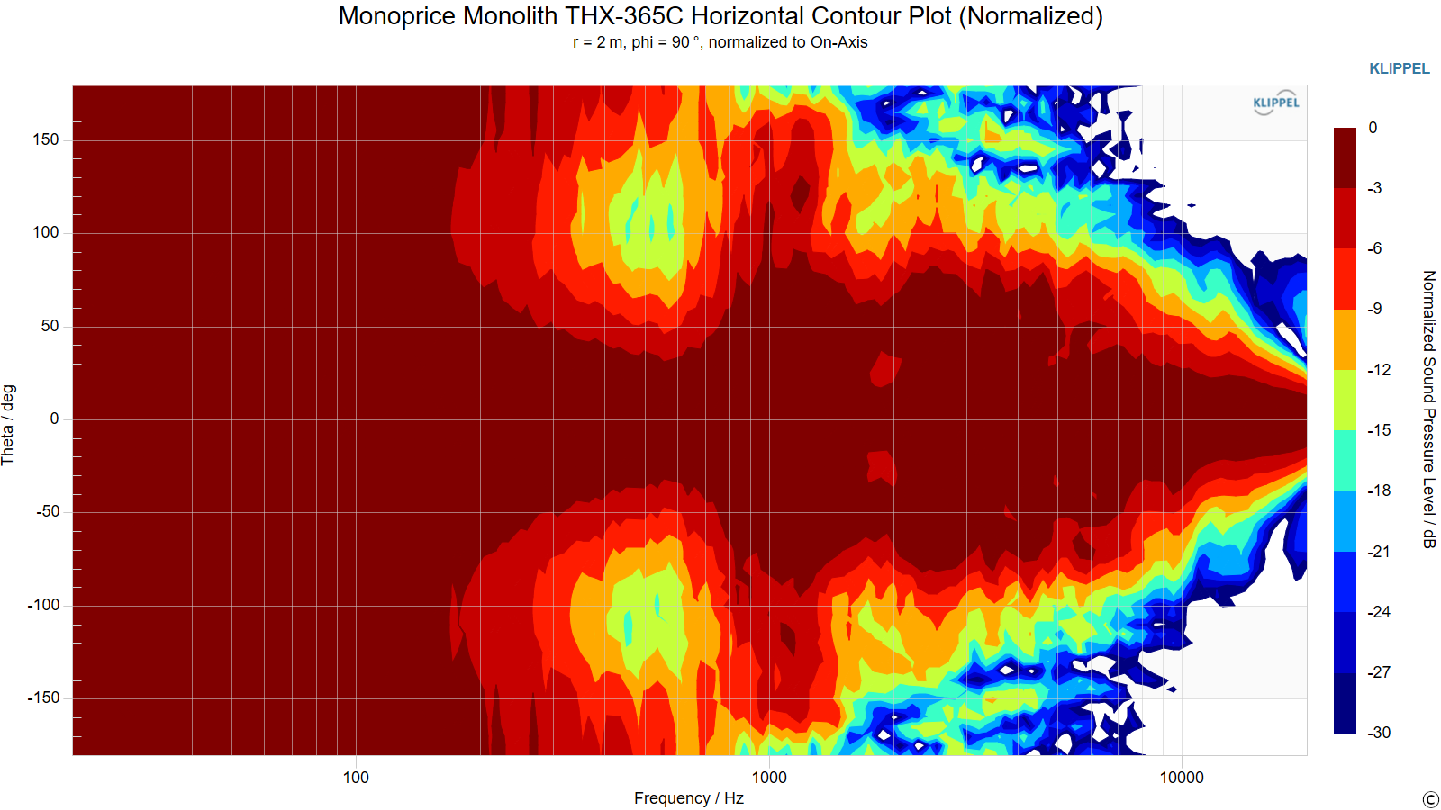

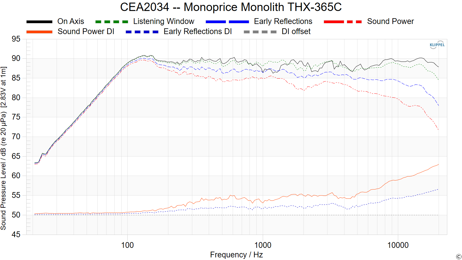

Sensitivity is around 89dB @ 2.83v/1m. The on-axis response shows a dip around 1kHz but the listening window doesn’t exhibit this. Overall horizontal radiation is pretty wide so there shouldn’t be an issue with a sweet spot in typical home theater seating. Output is solid, barring the compression I mentioned above. Distortion is really quite low. EQ’ability looks good except for the 4kHz region where there is a transition to the tweeter, though, this isn’t really all that bad, either. All in all, I think this may be one of the better center channels I’ve seen under the $500 mark.

I like loudspeakers with mid domes but the problem of using them at such WMW configuration is their too high crossover frequency which causes those lobes at the horizontal directivity. But still way better than most MTM centers and also very welcome buying alternative at that price range.
35 to 40 degrees off axis is not an issue.

The 96dB distortion performance is damned impressive for the money, not gonna lie.
Relatively flat on-axis, I see one resonance around 250hz in the impedance graph. Not sure quite what's going on around 2k, nothing pops out to me.
