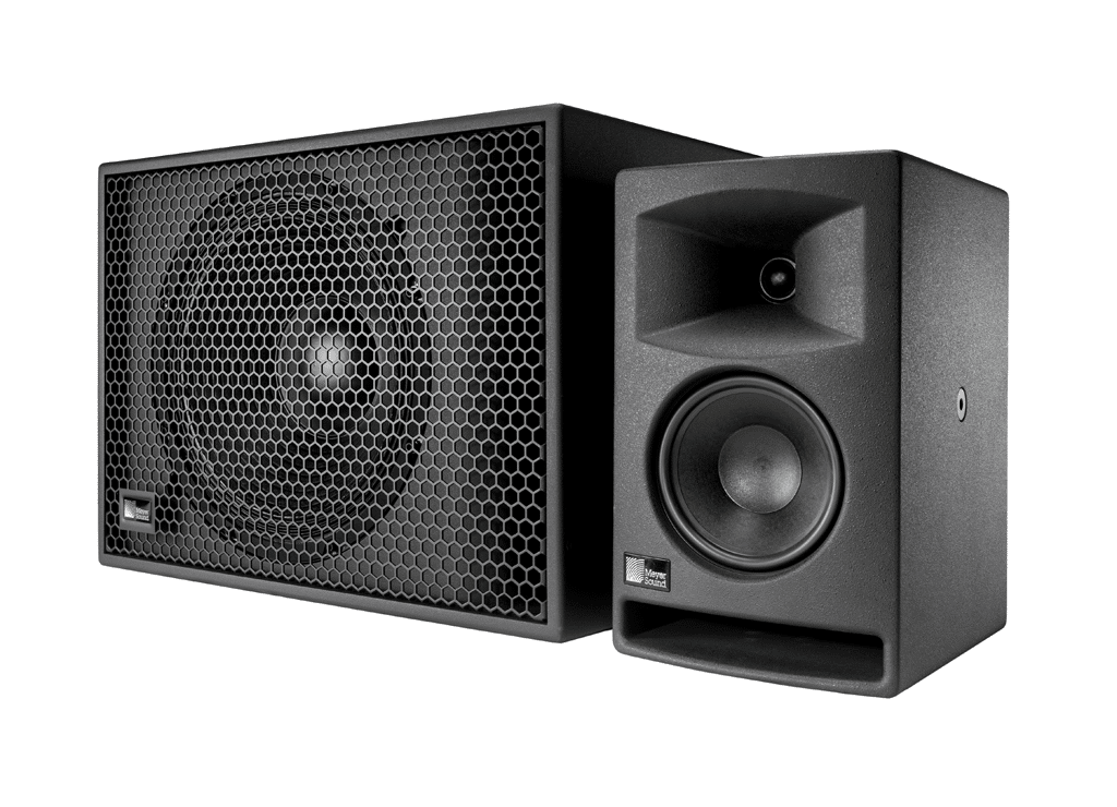

This is a review, listening test and detailed measurements of the Meyer Sound Amie Studio (active) monitor speaker. It is on kind loan from a member and costs US $4,080 each (sold in pairs?).
The deep, horn like waveguide sets the speaker apart from its competitors. The large throat of the port and larger than normal enclosure (relative to its woofer) imparts similar feeling. Speaker is not that heavy despite having a large heatsink on the back:
As you see, or rather don't, there is only a balanced input and speakon type connector for power. There are no controls for gain, bass, treble, etc. I am fine and actually happy with the latter two but did wish to have a gain setting. Driving the speaker at 0 dbu on the first test, I nearly jumped out of my chair in how loud the speaker played!
Speaker is designed and built in Berkeley California. In other words, some of the highest labor costs possible.
