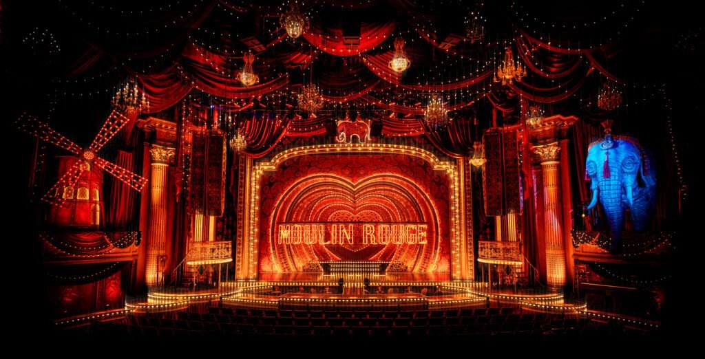

They are used as front fill speakers or balcony speakers in all sorts of venues where the main arrays have areas which are masked. So even when you see the massive line arrays, these smaller speakers are used to fill gaps WITHOUT disrupting the visuals of the stage.
They are small to avoid visual mass not because they are nearfield.
This is a good article about Moulin Rouge in Australia.
The Sound Rig
Main FOH line array: 28 x Meyer Sound Leopard
FOH sub arrays: 15 x Meyer Sound
900-LFC and 2 x Meyer Sound 1100-LFC
Fill speakers: Meyer Sound UPQ-D and Ultra-X40
Front fill (stage and passerelle): 48 x Meyer Sound MM-4XP
Delays: Meyer Sound UPM-1XP and MM-10ACX
Stalls delays: 20 x Meyer Sound UPJuniors
Circle Delays: 4 x Meyer Sound UPQ 1P, 4 x Meyer Sound 750-LFC
Rear delays: 3 x Meyer Sound MSL-4
On stage foldback: 36 x Meyer Sound MM4-XP
Scenery trucks: 4 x Meyer Sound UPM-1XP, 4 x Meyer Sound MM4-XP
