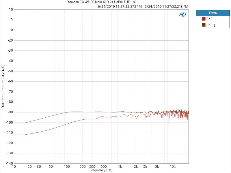

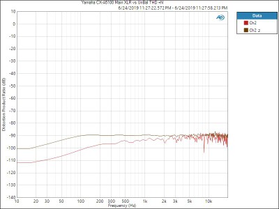

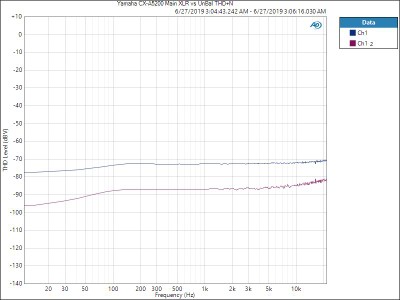

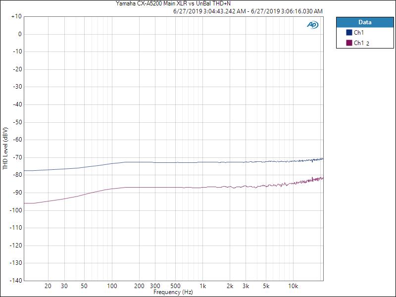

I wanted to verify if this problem plagued the CX-A5100 so I measured them side by side before swapping out my old CX-A5100 to review the CX-A5200. I ran identical tests on the CX-A5100 and CX-A5200 to show illustrate the differences in distortion at 2.7Vrms output for XLR and Unbalanced. As a reference, 2.7Vrms is almost the full voltage required for the MX-A5200 to reach max rated power.
Yamaha CX-A5100 Main XLR vs UnBal THD +N.jpg Yamaha CX-A5200 Main XLR vs UnBal THD +N.jpg
Distortion vs Frequency Response Yamaha CX-A5100 (left pic) ; CX-A5200 (right pic)
CX-A5100:
Brown: Unbal - 90dB @ 1kHz
Red: Bal -95dB @ 1kHz
CX-A5200:
Purple: Unbal -88dB @ 1kHz
Blue: Bal -72dB @ 1kHz
As you can see there's actually about a 23dB difference in distortion between the CX-A5100 and CX-A5200 at the same drive level and test conditions via the XLR outputs. The difference in distortion between the CX-A5100 and CX-A5200 unbalanced outputs was only 2dB in this comparison.
Yamaha confirmed my measurements and discovered the culprit to this increased distortion had something to do with how the volume control IC interacts with the XLR outputs. This is something they plan to resolve in future models but cannot make a hardware change to this current model.
