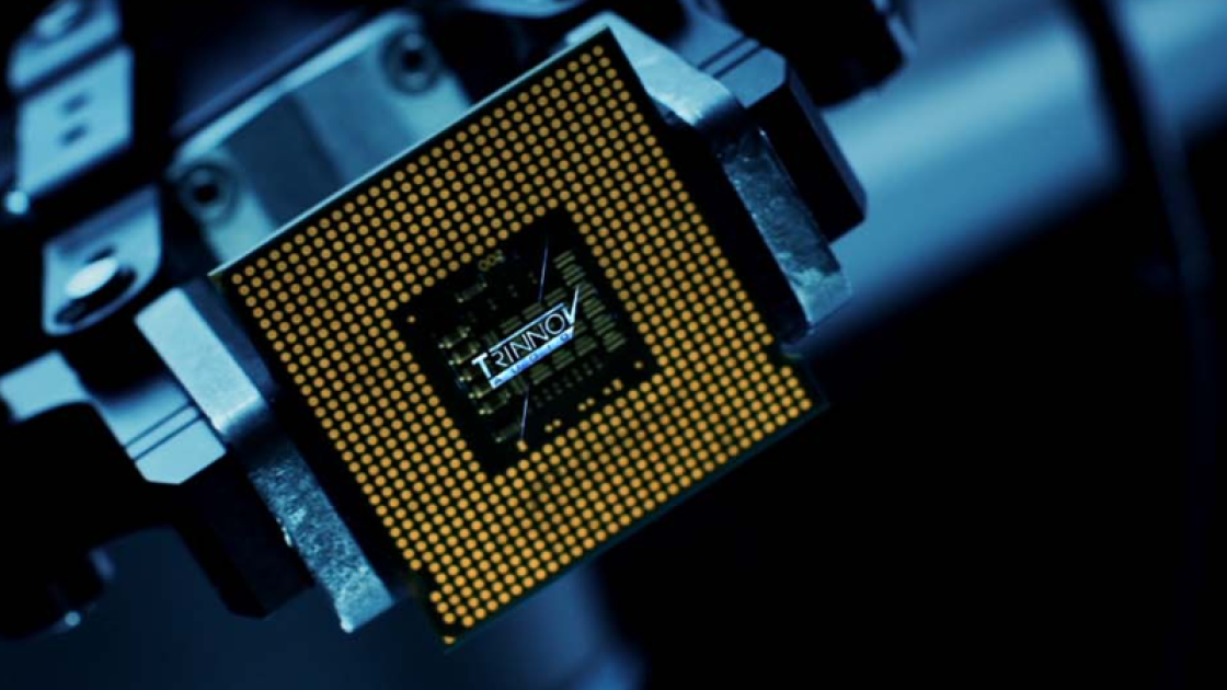

Talking about processing power, Trinnov has the following technicle article:
Based on one metric (I am sure there are others), the GLOPS:
In the examples they used for comparison, Masimo D+M's currently used ADSP-21593, has the second best in terms of GLOPS, but of course still much lower than Trinnov's in order of magnitude, but then Trinnov's waveforming probably would need much more, in order of magnitude than what Dirac ART/DLBC needs.
Anyone (such as @Dj7675 ) know what Storm Audio uses for DSP? Their website says "ADEC" decoder but I couldn't find any processing spec for that thing.

Storm uses bigger DSPs and I think dual in some models. They do run out of processing capacity with ART as they have 500 filters available and they note that this might not be enough for large channel count and cross-support systems.
Trinnov obviously does not run out of processing capacity and they have plenty. But they also have many more options for customisation compared to Storm. Their wave-forming is interesting, and sounds great (heard 2 big HTs using it), but then it is questionable how much more it brings than the 4x4 DBA which is the "minimum" requirement for the wave-forming hardware together with some really cumbersome placement requirements. In that respect, ART seems more efficient and less placement sensitive with the same hardware.
I believe that they too are using a "PC" motherboard, and that the ADEC is just the final DAC output stage - the processing is handled by the PC processor. (so pretty much the same as Trinnov)
