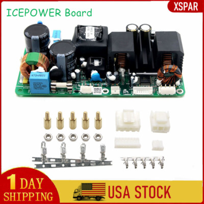

I ordered two 125asx2's from the seller xspar on Ebay Aug of 2021 and they've been good. They were $130 US each at the time.
I'm also using the VH500 cases designed by Guntar Smits, using the TI INA1650 here. Using the 125asx2 in bridged mode for 500w monobloc.
I don't see them on ebay at the moment.
