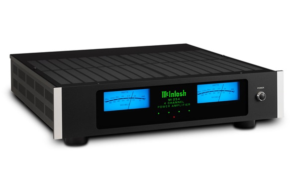

McIntosh MI254
$4500
250 wpc into 8 ohms
23.5 lbs (10.7 kg)

Interesting that the McIntosh MI254 is marketed as a "4-channel digital amplifier". I don't see any digital inputs or outputs :)
Strange specs too? Very high THD and very low damping factor for a Class D amplifier?
