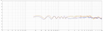

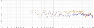

So I whipped out the 'ol REW again to measure them. Because of my small room wasn't able to get great measurements, but good enough to confirm what I heard:
2,5-3 dB boost from the 1961's from 2-9 kHz:.
Switched around the speakers, and exact the same was measured. Teal and yellow are 1961, red and blue are 8030c. The unit-unit comparison look great for both speakers though!
Measurements were at ~1m, gated at 5,8 ms.
What do y'all think, what could be the cause here? Anyone had the same experience?

Generally speaking, yes (but it's more complicated) . That's why I made a gated measurement, which eliminates the room. So the first one you see is reflection free. That shows the Arendal has a slight elevated treble.
