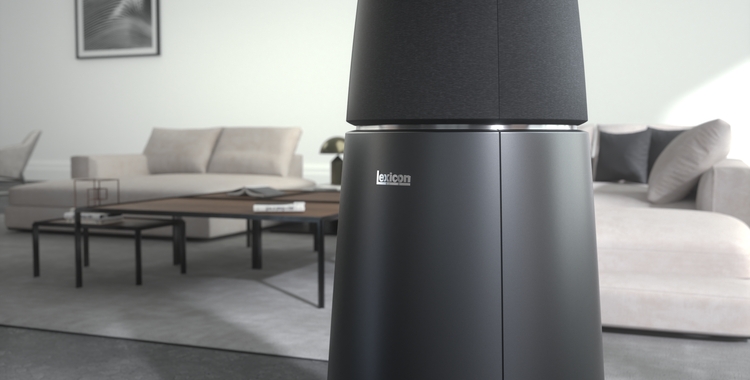

There is a Harman speaker Lexicon perhaps, looks like a pepper grinder.

Never even heard of this one. Is it even available? No matter, at least back in 2019 when released cost is $40k (!), so I am sure well over that now, and well above my budget
But thanks for the info regardless!

As to how Soundfield implements, it is done via the Hypex Fusion DSP and a nifty remote, no getting your lazy bum off the couch :)
Yeah, what a dysfunctional company. They spend R&D money and bring a statement product to market and then virtually keep it a secret.
And then there is branding...no one thinks of Lexicon as a speaker company. JBL, sure, Revel, you bet, even Infinity, but Lexicon? The rocket scientists who run Harman never fail to amaze me. Even the press release title is AUTOMOTIVE... really?
