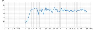

The attachment is an REW display of the response in the room at my listening position. Also, the room dimensions are 11' x 10' x 8' high, with a skylight at one side. The system and speakers are arranged along the longest wall. It's a small-ish room.
